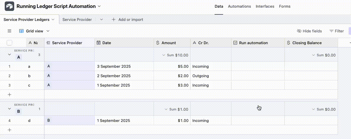

Hm, your script works fine:
I’m guessing your ‘Cr Dr.’ a single select field though as that would be how I’d set it up as well, if so you’d just update your code here to use the name instead:
if (crdr.name === "Incoming") {
closingBalance += amount;
console.log('incoming', closingBalance)
} else if (crdr.name === "Outgoing") {
closingBalance -= amount;
console.log('outgoing', closingBalance)
The problem then is that the comparison never works because the single select value is an object of ‘{name: “Incoming”}’ and we’re comparing it to a string ‘Incoming’
If that still doesn’t work, could you provide a screenshot of your table?  If you could DM me a link to a duplicated copy of your base that’d make it a lot easier to help you too, as without it I’ll have to attempt to recreate your base on my end instead

Yeah, your code’s working fine for that?  Sorry, I’m kind of confused as to what you’re asking!
Is the ‘Cr Dr.’ field a single select field?  If so, did you make the following update to your script and test it?
If it’s not a single select DM me a link to a duplicated copy of your base and I can take a look at it for you!
