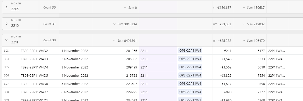

Hello, I managed to make the running total work however I would like to restart the sum month by month. Any idea how can I do this?
  • Apr 24, 2023 3:28 PM UTC
I have a field called month which is the one filtering the records and should restart on ) at every different month value
