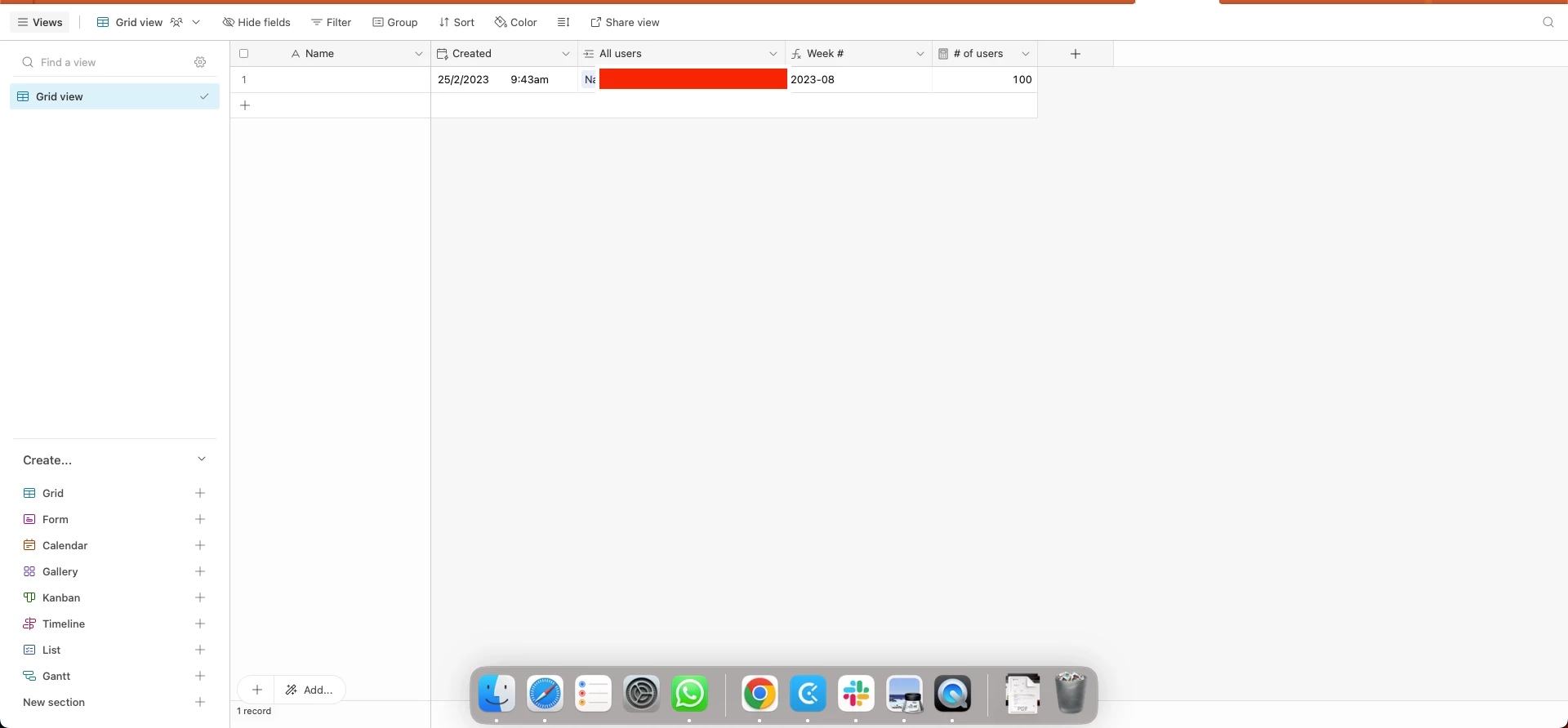

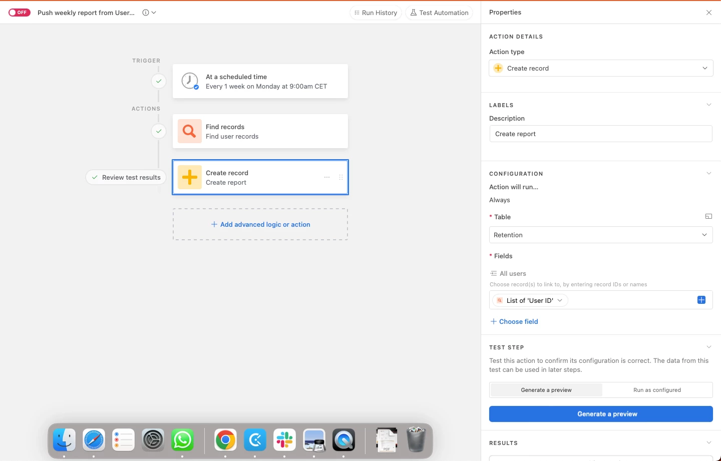

Dear community,
This is my first time posting here but I would like a script that allows me to find > 100 records. Automations has a limit of 100. All the script needs to do is find all the records in my 'user' and update them as linked records in a column in the 'retention' table.
Reason for this is that I want to calculate the retention of the user base, unfortunately I have 1300 records/users that I need to include all of them in this calculation. Does anyone have any experience with this?
