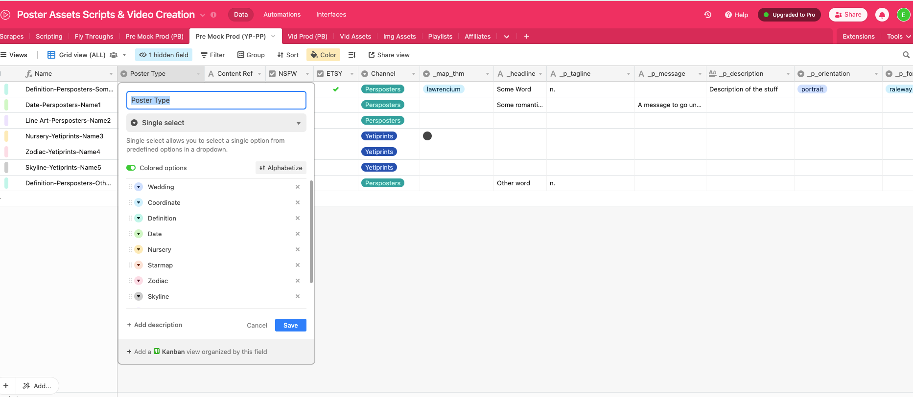

Thanks so much for the response Kuovonne, see attached column headers. I just don't get it, there are no errors being thrown and the tests all run successfully but the execution log is blank.

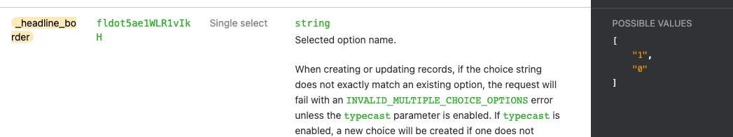

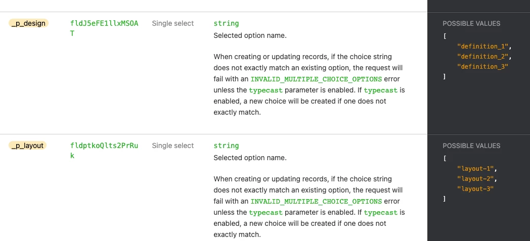

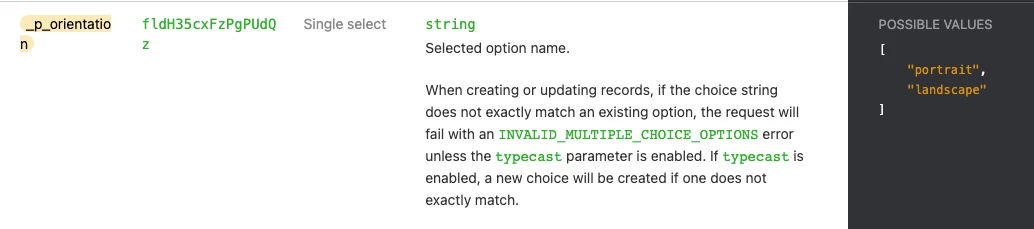

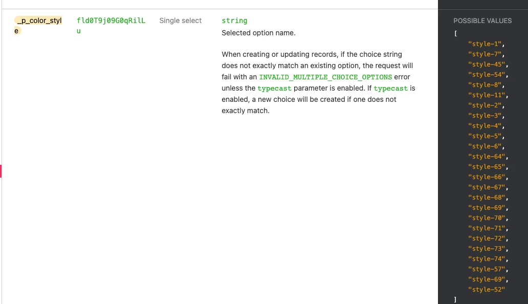

OK so I have made a little more progress but still haven't worked it out...I have modified the code to this:
let table = base.getTable("Pre Mock Prod (YP-PP)"); let query = await table.selectRecordsAsync(); let records = query.records; for (let i = 0; i < records.length; i++) { let currentRecord = records[i]; let posterType = currentRecord.getCellValue("Poster Type"); if (posterType.name === "Definition") { let options = ["_p_design", "_p_layout", "_p_color_style", "_headline_border", "_p_orientation"]; let randomIndex = Math.floor(Math.random() * options.length); let randomOption = options[randomIndex]; let recordId = currentRecord.id; let optionValues = { _p_design: ["definition_1", "definition_2", "definition_3"], _p_layout: ["layout-1", "layout-2", "layout-3"], _p_color_style: ["style-1", "style-7", "style-45", "style-54", "style-8", "style-11", "style-2", "style-3", "style-4", "style-5", "style-6", "style-64", "style-65", "style-66", "style-67", "style-68", "style-69", "style-70", "style-71", "style-72", "style-73", "style-74", "style-57", "style-69", "style-52"], _headline_border: ["1","0"], _p_orientation: ["portrait", "landscape"] }; let randomOptionValue = optionValues[randomOption][Math.floor(Math.random() * optionValues[randomOption].length)]; console.log(randomOptionValue); await table.updateRecordAsync(recordId, { [randomOption]: randomOptionValue }); } }
I first checked that all the values were properly set and that there were no typos. But it seems from the console.log output that the script only returns 1 random value, regardless of whether it belongs to the field or not. It therefore not accepted as a value by the field.
What should happen is that only 1 random value per field should be inputed. HOw would I modify the script to do this? If this is indeed the problem?
