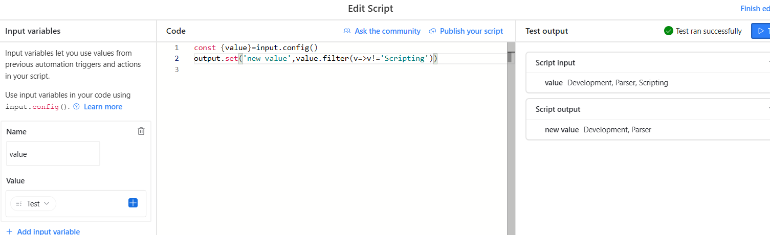

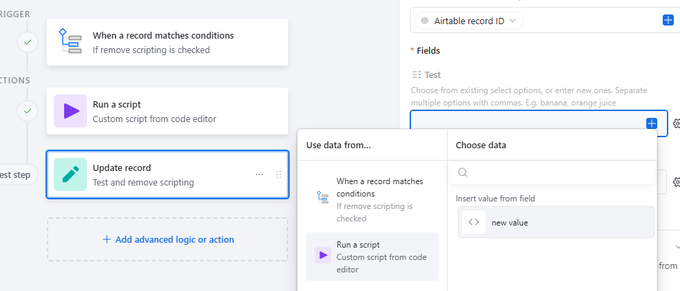

If you need to remove  'language' from the whole field, or from given part of records which you can filter, and you want to do that as one-time action, you can create a formula with substitute, as @TheTimeSavingCo advices, but you might have problems with comma when a 'language' is last selected option in the list.
A solution, easier for beginners, is to duplicate the field, enter duplicate field settings and remove that option. Then copy-paste whole field back from duplicate to original field. You can filter records before copy-pasting, so the operation will only affect visible records.
If you really need this to be done as part of automation, I think this example is clear. Don't forget to change word 'Scripting' to your option 'language'

This is a case where level of chatGPT over-engineering can be described as very close to "sh*t-coding" 😁 (sorry)
