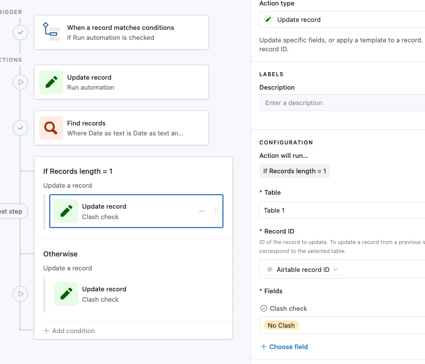

Hey ​@James_Henry,
I should play around with it, but there is probably a no-code approach to this. Did you try the following:
Create an Assets table (not fully needed I believe, but recommended).
Link Assets to Hire Days table.
Create an automation: Each time a record gets created (or updated) on Hire Days, trigger the automation. Have a Search Records action on the Hire Days table to find any other record where Date = {Date} and Assets = {Assets}.
Have Conditional Logic on your automation (two branches)
If length of records found is >1 then update the record that triggered the automation to Clash.
Otherwise, update the record that triggered the automation to No Clash.
Please feel free to grab a slot if you’d like us to go through it together! I’d be happy to help.

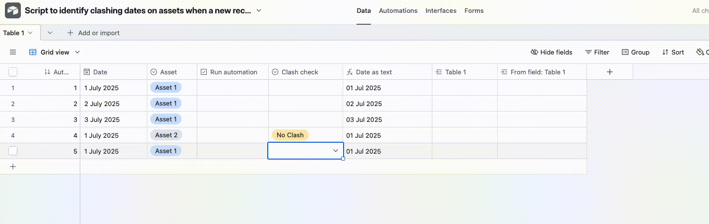

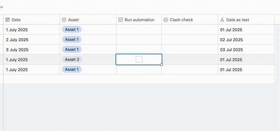

Does this look right?  If so I’ve set it up here for you to check out and you can duplicate it into your own workspace to play with it
And this is how the automation looks.  Hit me up if you have any questions!

Hi Adam,
Yours is the solution I tried to integrate first of all and it has worked perfectly!! Thanks a heap.
Nice, glad it’s working!  Hmm what if you used a linked field for this instead?  I updated the base with this new automation (v2 - Identify clashing records) as well, and it now checks whether the autonumber is the same to prevent it from linking itself
