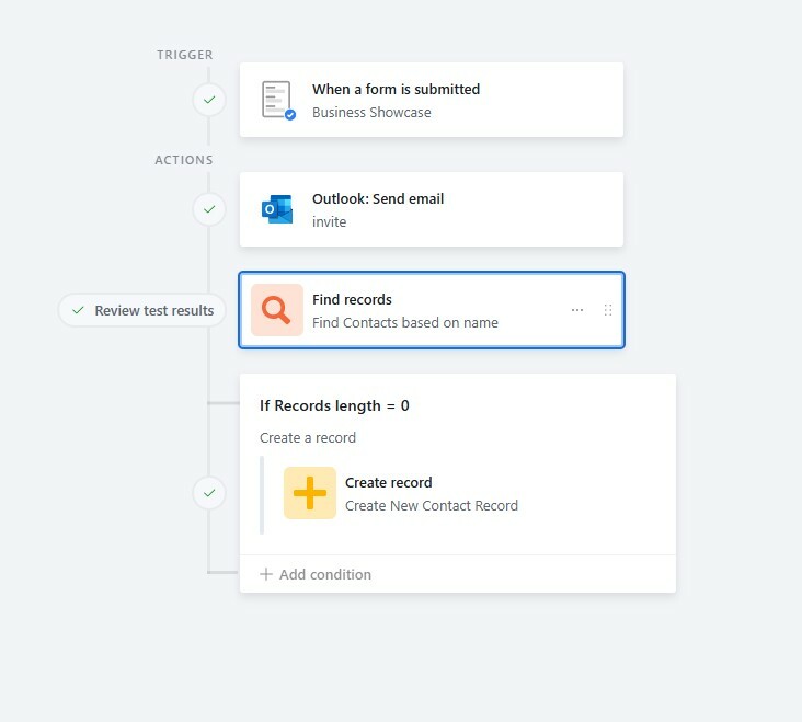

Hi, i'm a total novice and really struggling with an automation, any help greatly appreciated pls 🙂
My client hosts quarterly events, attendees register via airtable form.
I am familiar with creating the form and the automated email reply. But thereafter the client would like to check the existing 'Contacts' tab to see if the attendee is an existing contact:
If so, do nothing
If not, create a new contact in the 'Contacts' tab.
I am stuck on the find records step, I'm not sure how to ask it to check the contacts table. When I look online it says to do find records, but I'm not sure of the conditions.

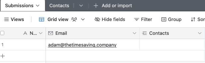

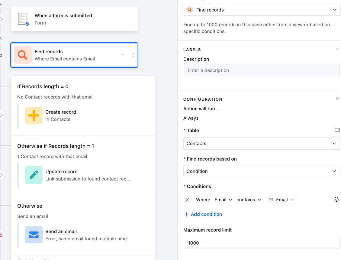

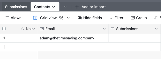

Hmm, assuming your data's set up like this:
Then you'd get your automation to check whether it found any records in the 'Contacts' table with the same email value that was just submitted.  If it found one record, then link it together.  If it didn't find anything, create it and link it to the new Submission record.  If it found >1 record with that email, send you a notification so you can figure out what went wrong
