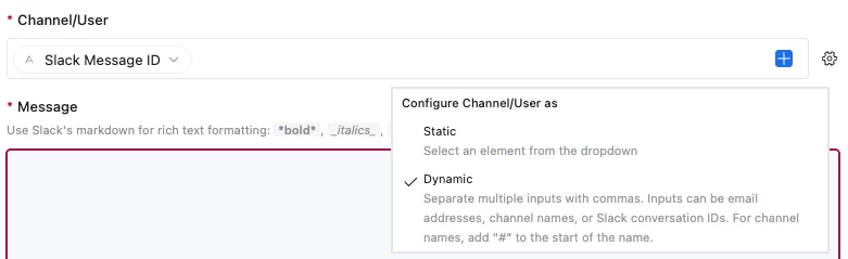

We are looking to reply to specific Slack messages to update product status. While it looks like it’s possible through Slack conversation IDs, I haven’t found documentation on how to set it up. Does anyone know how to do this without an external automation?

You can't do that from Airtable native integration with slack. You would need to use a tool like Make.com
The Field channel/user is to point out the channel you are sending the message to.
If you want to reply in a message you can use a make.com module that you can write a reply and in the settings you use the message ID for the message you want to reply to.

As mentioned, Make is a no go per the company’s policies. If someone has relevant information to the original request, it will be appreciated.
I can use a channel ID (CID) and I can use a user ID so it’s curious that it doesn’t allow the thread time stamp (thread_ts) to reply to a channel thread per Slack’s API.

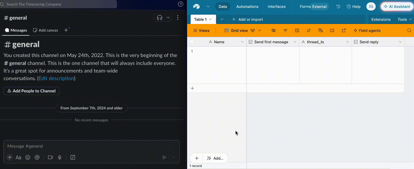

Yes, it would work perfectly fine, because scripts can make API calls to external apps.
And this is natively built into Airtable, because you can run scripts from Airtable’s automations.
When the first Slack message is created from Airtable, it needs a JavaScript to make the first API call to Slack to create the message.
Then, Slack would return the thread ID to the script, which the script would store in the Airtable record.
Future replies would use JavaScript to make another API call to reply to the original message.
It would be relatively quick & easy to setup. Shouldn’t take more than a few minutes.
Does this look right?  If so, I’ve set it up here for you to check out
Airtable’s Slack action doesn’t expose thread_ts, so we’re just using a Run a Script action to send the message, then log the thread_ts value after that
‘Send reply’ then triggers another automation that’ll use the thread_ts value to send the next message
Slack’s API is pretty painless so with this base as a reference and a bit of googling you’ll be fine.  Hit me up if you encounter any issues and I’ll do what I can to help!
