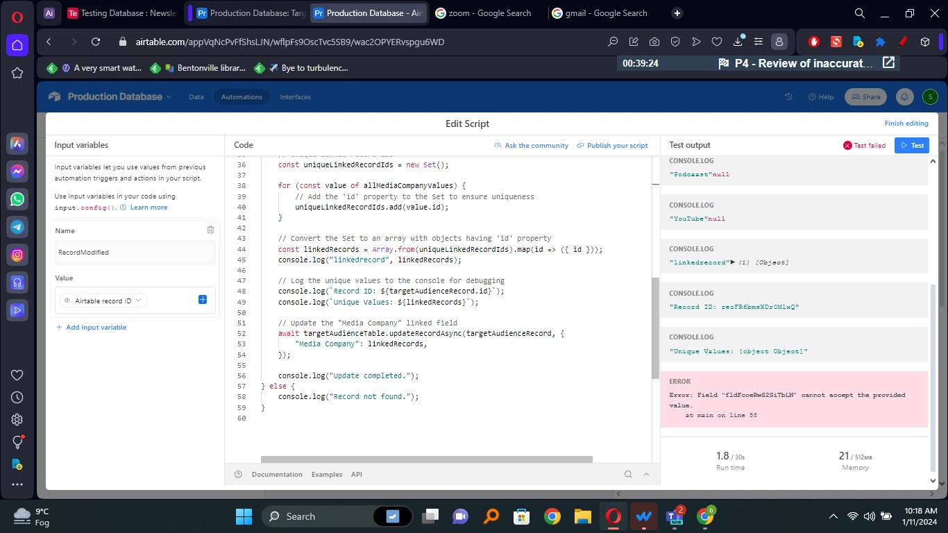

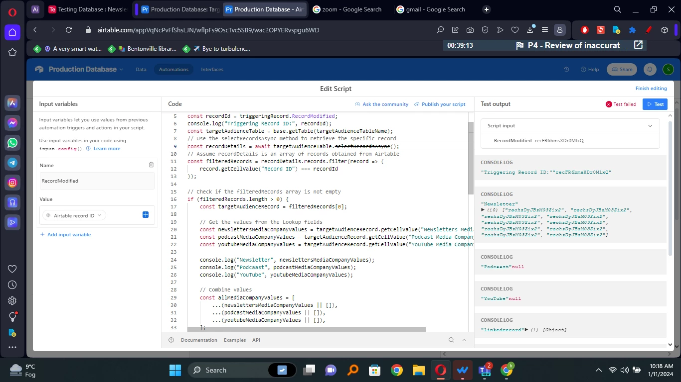

the script is not taking input as want to update values in linked field
  • January 11, 2024
  • 80 views
code:
const targetAudienceTableName = "Target Audience SS";
// Access the record ID from the triggering record
const triggeringRecord = input.config();
const recordId = triggeringRecord.RecordModified;
console.log("Triggering Record ID:", recordId);
const targetAudienceTable = base.getTable(targetAudienceTableName);
// Use the selectRecordsAsync method to retrieve the specific record
const recordDetails = await targetAudienceTable.selectRecordsAsync();
// Assume recordDetails is an array of records obtained from Airtable
const filteredRecords = recordDetails.records.filter(record => (
    record.getCellValue("Record ID") === recordId
// Check if the filteredRecords array is not empty
if (filteredRecords.length > 0) {
    const targetAudienceRecord = filteredRecords[0];
    // Get the values from the Lookup fields
    const newslettersMediaCompanyValues = targetAudienceRecord.getCellValue("Newsletters Media Company");
    const podcastMediaCompanyValues = targetAudienceRecord.getCellValue("Podcast Media Company");
    const youtubeMediaCompanyValues = targetAudienceRecord.getCellValue("YouTube Media Company");
    console.log("Newsletter", newslettersMediaCompanyValues);
    console.log("Podcaast", podcastMediaCompanyValues);
    console.log("YouTube", youtubeMediaCompanyValues);
    // Combine values
    const allMediaCompanyValues = [
        ...(newslettersMediaCompanyValues || []),
        ...(podcastMediaCompanyValues || []),
        ...(youtubeMediaCompanyValues || []),
    // Unique linked record IDs
    const uniqueLinkedRecordIds = new Set();
    for (const value of allMediaCompanyValues) {
        // Add the 'id' property to the Set to ensure uniqueness
        uniqueLinkedRecordIds.add(value.id);
    // Convert the Set to an array with objects having 'id' property
    const linkedRecords = Array.from(uniqueLinkedRecordIds).map(id => ({ id }));
    console.log("linkedrecord", linkedRecords);
    // Log the unique values to the console for debugging
    console.log(`Record ID: ${targetAudienceRecord.id}`);
    console.log(`Unique Values: ${linkedRecords}`);
    // Update the "Media Company" linked field
    await targetAudienceTable.updateRecordAsync(targetAudienceRecord, {
        "Media Company": linkedRecords,
    console.log("Update completed.");
} else {
    console.log("Record not found.");
Output:
CONSOLE.LOG
  1. "Triggering Record ID:"
  1. "recFR6bmsXDr0MlxQ"
CONSOLE.LOG
  1. "Newsletter"
  1. ▶(10) ["rechzDyJBzM03Zix2", "rechzDyJBzM03Zix2", "rechzDyJBzM03Zix2", "rechzDyJBzM03Zix2", "rechzDyJBzM03Zix2", "rechzDyJBzM03Zix2", "rechzDyJBzM03Zix2", "rechzDyJBzM03Zix2", "rechzDyJBzM03Zix2", "rechzDyJBzM03Zix2"]
CONSOLE.LOG
  1. "Podcaast"
  1. null
CONSOLE.LOG
  1. "YouTube"
  1. null
CONSOLE.LOG
  1. "linkedrecord"
  1. ▶(1) [Object]
CONSOLE.LOG
  1. "Record ID: recFR6bmsXDr0MlxQ"
CONSOLE.LOG
  1. "Unique Values: [object Object]"
ERROR
Error: Field "fldFcoeRwS2SiTbLN" cannot accept the provided value.
    at main on line 58
