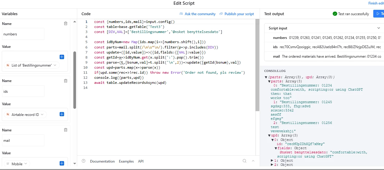

Hard to say without an example of your full email text I’m afraid.  When you tried it out did it work right?
Alexey_Gusev
Forum|alt.badge.img+25
Parsing require precision in details, so you can test and see if script works.

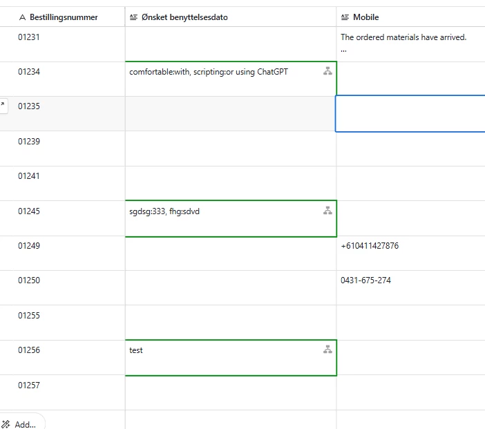

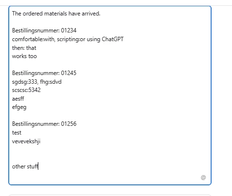

I just made a small test with a different approach - I did Find records for Ordered status and then used results to avoid querying in script.
You can use it in case of any problems with ChatGPT version
From Find Records, order numbers added as ‘numbers’  and record IDs added as ‘ids’  at the left side of editor. Email text added as ‘mail’
I just typed random nonsense for test
Looks good
Of course if your email text has differences it might not work for you. Or you should make minor fix in the script.
const {numbers,ids,mail}=input.config()
const table=base.getTable('Orders')
const [DIV,VAL]=['Bestillingsnummer','Ønsket benyttelsesdato']
const idByNum=new Map(ids.map(i=>[numbers.shift(),i]))
const parts=mail.split(/\n\s*\n/).filter(p=>p.includes(DIV))
const update=([id,value])=>({id,fields:{[VAL]:value}})
const getId=x=>idByNum.get(x.split(':').pop().trim())
const parse=(t,[bsnum,val]=t.split('\n',2))=>update([getId(bsnum),val])
const upd=parts.map(x=>parse(x))
console.log({parts,upd})
if(upd.some(rec=>!rec.id)) throw new Error('Order not found, pls review')
await table.updateRecordsAsync(upd)
