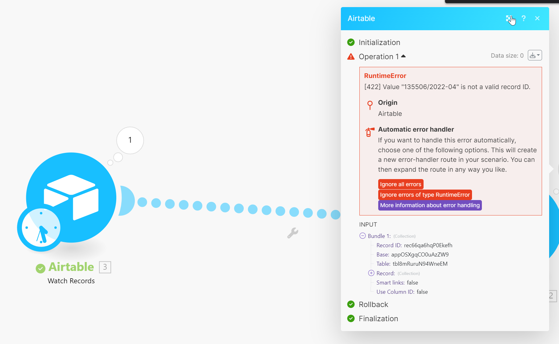

I am trying to set the same automation / scenario up in Make.  I am using a 'Watch Record', together with 'Update Record'.  The problem I am facing, is that when I try to set in Make the CleanerMonthlyInvoiceLink to a value like 'CLEANSOL-01', it is giving me an error saying:  [422] Value "135506/2022-04" is not a valid record ID.
It is expecting the actual record ID, something like rec66qa6hqP0Ekefh. This is not available to me at this stage, since the record could possibly not have been created. Of course, I could create all the logic behind checking if record exists, creating it if not etc, but this would make it much more complicated.

That actually isn't a Make limitation, that's an Airtable API limitation unless you turn on "typecast" in Airtable's API.
The way to turn on "typecast" in Make is to toggle on Make's "Smart Links" toggle at the bottom of Make’s Airtable modules. (I have no idea why Make doesn’t call it by its official name “typecast”.)
 This is actually described on Make's documentation for the Airtable modules, but you can just turn it on without reading the documentation.
Also, on an related note, when you are using Make to create brand new records in an Airtable table (not via the linked record field -- but by actually going into the table and creating new records), you may want to look into Make's Upsert module for Airtable... which gives you 2 functions within one module: It will either create a new record if it doesn't already exist, or it will update an existing record if it already exists.

@ScottWorld I simply didnt see the Smart Links feature - thanks for pointing that out! Worked like a charm. And watched you video, had no idea that you could move that little clock thing to put another node as a starting point, I thought it just couldn't be done! Thanks a lot for your help.
