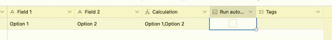

Hmm I managed to get a very simple version of this working here:
Hard to say why yours might be giving you problems though
