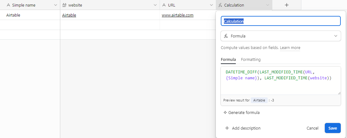

1) Set the "Simple name" and "URL" fields to one line text. Website is a long text with rich text formatting. Create a calculation that's the time difference between modifications
DATETIME_DIFF(LAST_MODIFIED_TIME(URL, {Simple name}), LAST_MODIFIED_TIME(website))

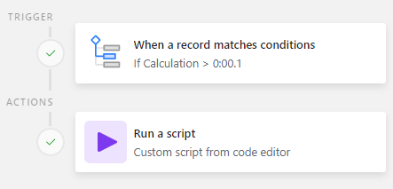

2) Create an automation triggered by the calculated time exceeding some number. I set it to 0:00.1. That might need to be tweaked later depending on how Airtable backend does things, so I'll monitor that

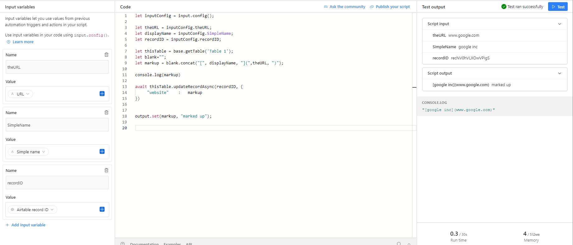

3) Create a script as such:
let inputConfig = input.config(); let theURL = inputConfig.theURL; let displayName = inputConfig.SimpleName; let recordID = inputConfig.recordID; let thisTable = base.getTable('Table 1'); let blank=""; let markup = blank.concat("[", displayName, "](",theURL, ")"); console.log(markup) await thisTable.updateRecordAsync(recordID, { "website" : markup })
