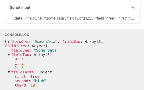

Best answer by Justin_Barrett
That’s unfortunately the current limitation of the webhook trigger. However, you can actually work with that and get what you want.
In short, you stringify your main object, then stringify it again when inserting into the body of the request. Here’s a quick example that I just tested:
const hookUrl = "https://hooks.airtable.com/workflows/v1/genericWebhook/..."
const myObject = {
    "fieldOne": "Some data",
    "fieldTwo": [1, 2, 3],
    "fieldThree": {
        first: true,
        second: "blah",
        third: 19
const options = {
    method: "POST",
    headers: {
        "Content-Type": "application/json"
    body: JSON.stringify({
        data: JSON.stringify(myObject)
const response = await remoteFetchAsync(hookUrl, options)
if (response.ok) {
    output.text("OK")
} else {
    output.text("Not OK")
On the receiving end, you only have a single data item to pass to your script, which is the string version of your original object. Turn it back into the original object using JSON.parse():
const {data} = input.config()
const myObject = JSON.parse(data)
console.log(myObject)

Thanks… Yep… I sent the complete object after testing it without the additional key/pairs and it works. Just of a strange feature.
