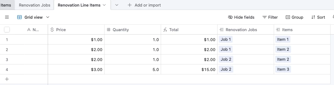

Hm try using an Interface for this?  I’ve something up here for you to check out and you can duplicate it into your own workspace to try it out
The idea is to use a Blank interface, put in a Record Selector element and pick the job you want.  Then in this grid view of all the items, you can select how much of each you want and check the In Use checkbox, and then hit the button that will trigger an automation
This automation will create one record per selected item in a new table called Renovation Line Items.  This lets you keep all of this item level data because if not, like the next time you create a job, all this information will be lost.
