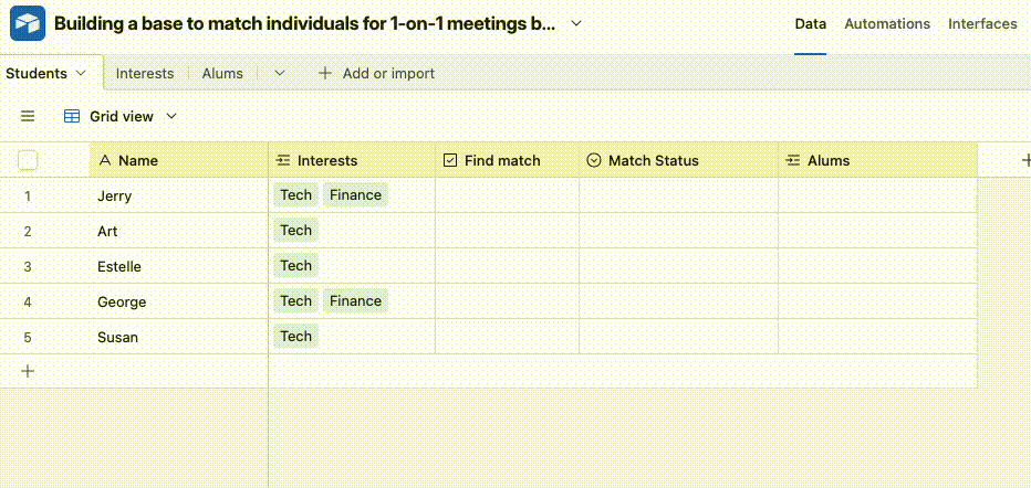

Does this look right?  If so I’ve set it up here for you to check out

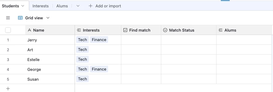

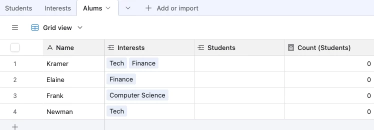

And this is what the data looks like:

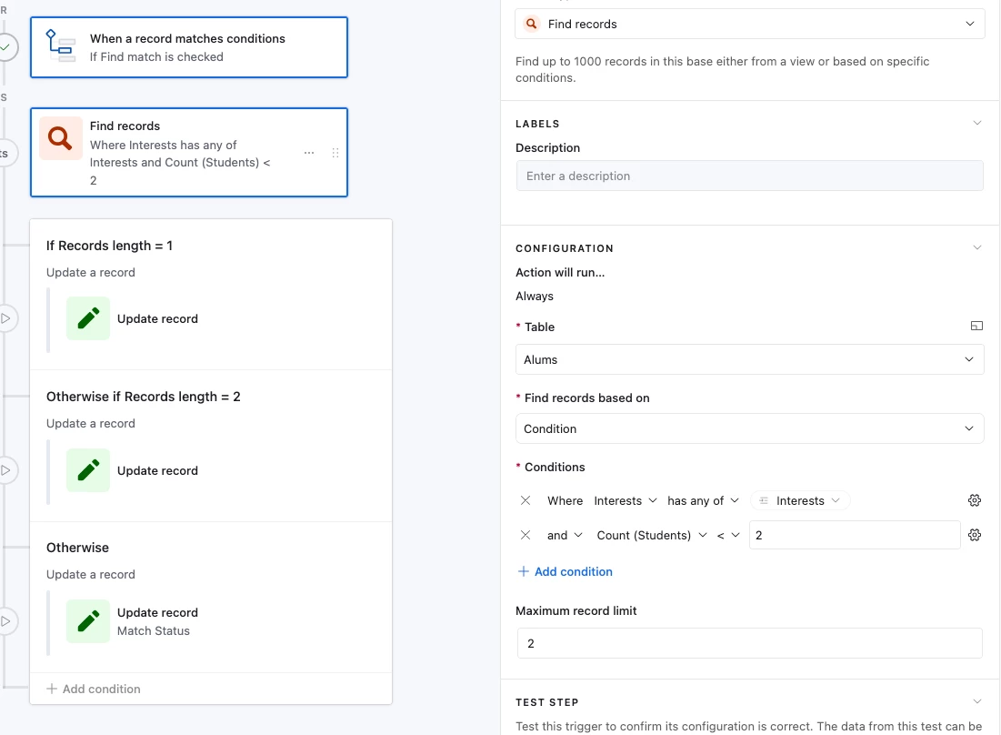

And here’s the automation:
The automation looks for any Alums that share any of the same Interests and have less than 2 students linked and then links them to the Student, and the conditionals there are updates for you to see what’s missing and update stuff manually if needed
The main issue with running this that you’ll have to manually click the checkbox for each student and wait for it to run as there isn’t a way to run things sequentially via an automation right now.  If you checked all the boxes at once they’d all run at the same time and potentially link Alums to more than 2 students, just because at the point at which the automation ran that Alum had <2 links, does that make sense?  (You could of course write a script to do things sequentially, but that’s a whole other can of worms)
