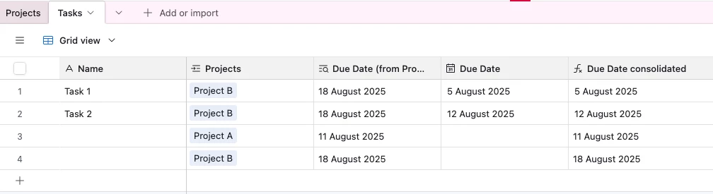

Unfortunately Calendar views can only take data from a single table at this point, and so your best bet’s going to be attempting to create a table that has all the data
Perhaps you could try an automation that’ll trigger whenever a new record’s created in the ‘Projects’ table, and its action will be to create a new record in the ‘Tasks’ table and link itself to it.  The Tasks table would then contain both the Project and Task records, and then you’d use a formula field to consolidate it for the calendar display:
The downside to this is that now you can’t drag and drop the dates in the Calendar view.  You can get around this by getting the automation that creates the record to also paste the ‘Date’ value into the ‘Due Date' field, and after that you’ll need to set up another automation to make sure that whatever updates you make to a Project’s ‘Due Date’ value in ‘Tasks’ gets synced back over to the Projects table

Thanks Adam--this makes sense. I'm about 75% there, but cannot seem to get that final automation to work. Where I’m trying to change the date on the original project record in the “projects” table by editing the date on the duped project record in the “tasks” table. The automation keeps showing an error. ​@TheTimeSavingCo

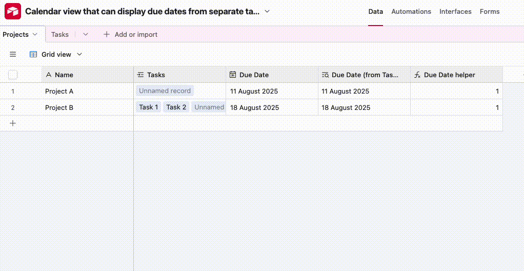

Hm could you provide a screenshot of the error you’re getting?  Here’s an example I setup and you can duplicate it to your own workspace to see how it works.  The lookup field has a conditional on it to only show the Due Date value for records with type ‘Project’, and the formula field has this:
IS_SAME(
{Due Date},
{Due Date (from Tasks)}

yeah, that did it ​@TheTimeSavingCo --thanks for sharing your base. And taking it a step further, in order for my calendar view (tasks table) to be useful for moving those project dates around, I can base the calendar on the “task due date,” correct?
Yeap that’s right
