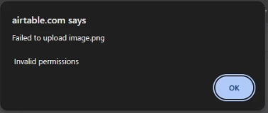

When they click the attachment field, they get the window to attach a file, but once they click upload, they get a browser warning saying invalid permissions. This happens with all of my users that are viewer license level. Anyone that has editor can add attachments with no issues. Here is the browser alert they get. Confirmed no browser extensions are running as well,

I don't know if this makes a difference, but this is on the enterprise licensing. All of my users that have editor license are able to upload attachments in the form with no issues. All of the users that have viewer licenses are unable to upload attachments in forms. As ​@ScottWorld mentioned I think I will need to get Airtable support involved as this does seem to be unintended behavior.

Yeah, that’s weird. Sounds like a bug. Be sure to report it to support@airtable.com, and then let us know what they say!
