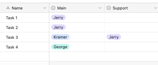

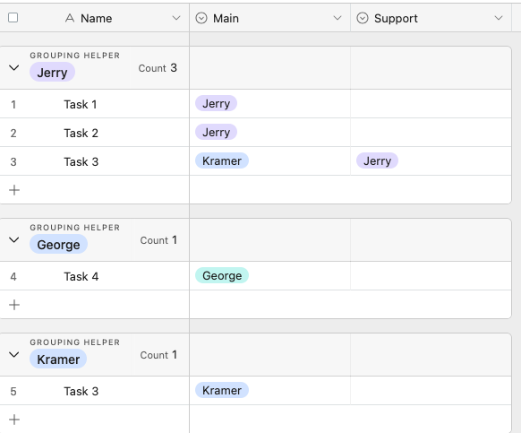

Hmm, so let's say your data looks like this:
Is the following what you want to see?
If so, this is possible, but you would need to create helper records as (with reference to the example above) we need "Task 3" to show up twice in the same table

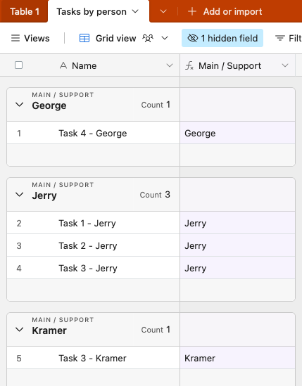

I think I'd recommend having a separate table for this instead called "Tasks by person" or something, and so each of these "Tasks" records would have a record for "Main" and a record for "Support"; would be more intuitive to manage and you could see stuff like this:

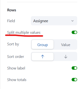

Ideally I want it to work like in an interface pivot table where there is just a switch that splits grouped tasks up by just the assignee. It doesn't seem like that is possible at this time.
