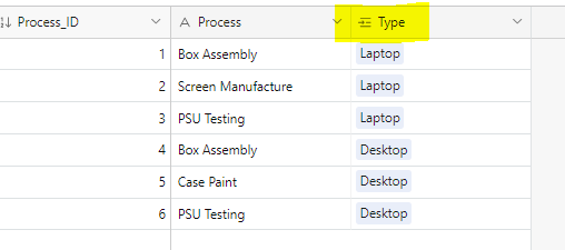

Then I have another table called 'Processes' with only two fields
TypeProcess
LaptopBox Assembly
LaptopScreen Manufacture
LaptopPSU Testing
DesktopBox Assembly
DesktopCase Paint
DesktopPSU Testing

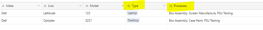

On the Product Table, I'd like it to "lookup" the selected product type and complete a field containing all of the processes.
TypeProcess
LaptopBox Assembly, Screen Manufacture, PSU Testing
DesktopBox Assembly, Case Paint, PSU Testing

I think that you need to create a "Type" table achieve what you want:
Then, in your "Processes" table you link the field Type to table Type:

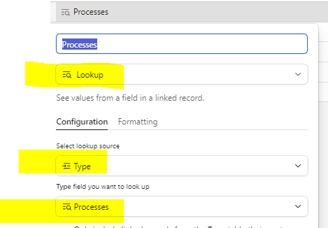

Then, you add a lookfield in table Type to list all possible processes:

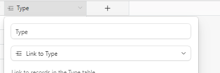

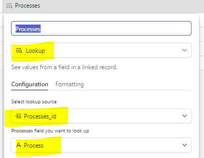

Then, in table "Products", you link field "Type" to table Type and you add a lookup field to get possible processes from table type:
