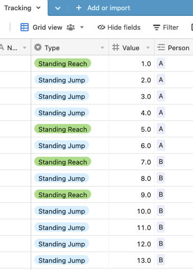

Hi @James_Chi, if I were you I’d have two tables, one to contain the athletes and one to contain the score tracking

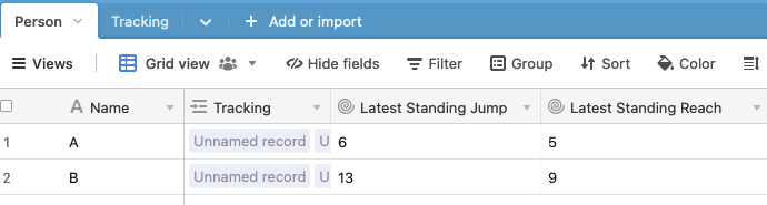

From there, I’d link each tracked score to the appropriate athlete record, and then use the rollups to get the latest tracked score of each type, resulting in something like this:
And here’s a base I set up that shows how to do the rollup thing
