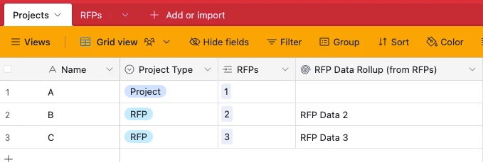

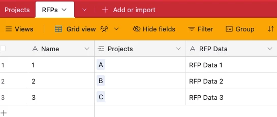

If you’ve already got everything linked and it’s about display, then maybe you could use a rollup field with the following formula:
{Project Type} = 'RFP',
ARRAYUNIQUE(values)
