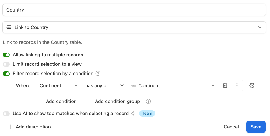

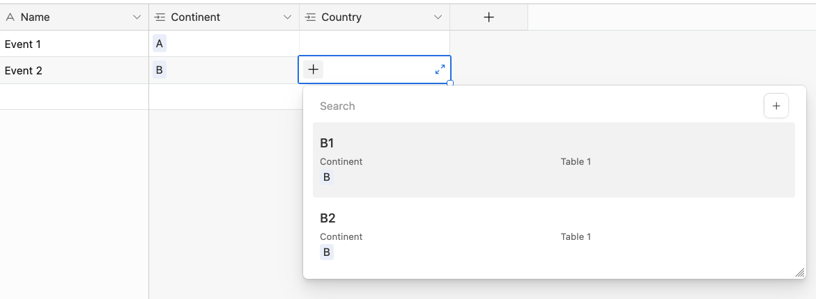

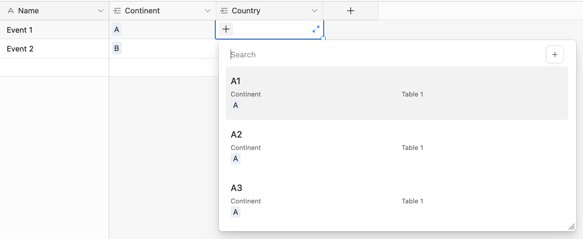

If you're on a paid plan, try creating a linked field and using the 'Filter record selection by condition' option.

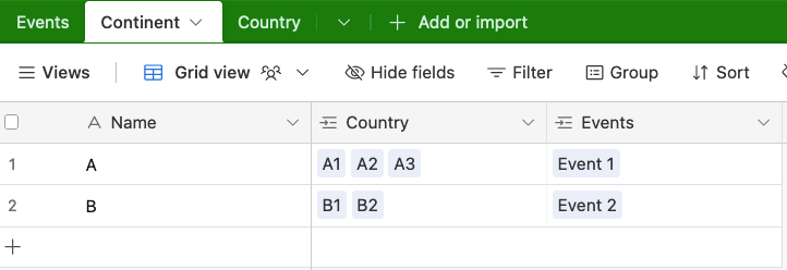

Here's the how the "Continent" table is set up:
And in the "Event" table there's a "Country" field with a the "Filter record selection by condition" option toggled on and set up like so:
And so when linking a record, the available options are filtered:

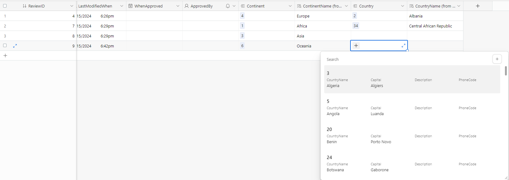

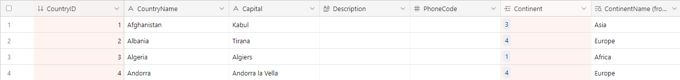

I had previously looked into exactly what you put in the above answer. In the Events table I added a continent field that was a lookup to the continents table. That worked simply, without a hitch. Since I had already created a Country table, and added the continent for each country (please see the following small example):

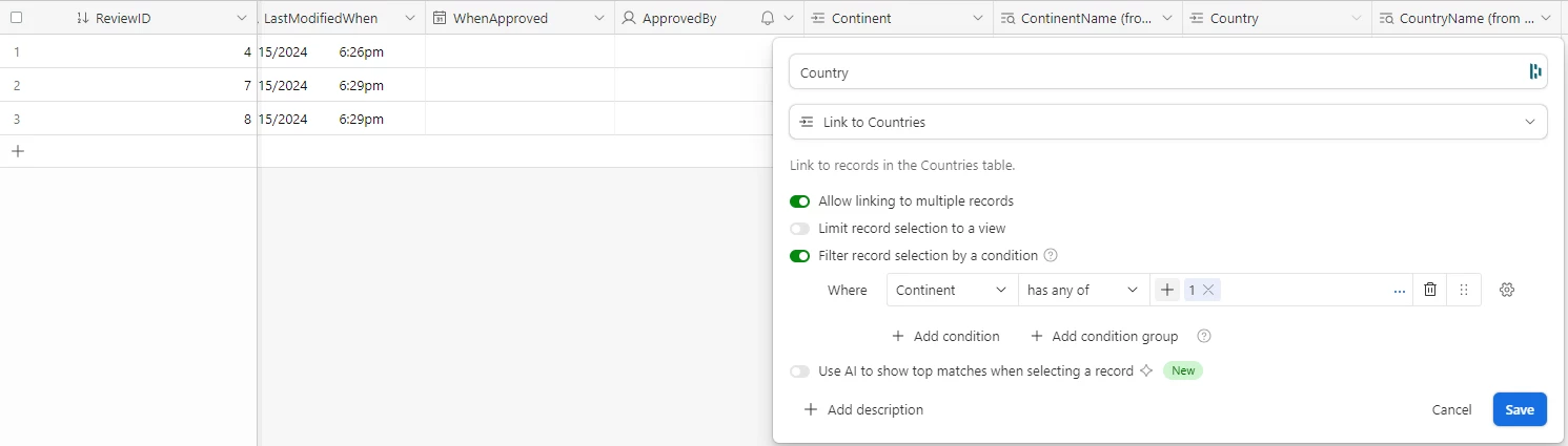

Next, I had added a country field to the Events table - it was the obvious thing to do. And I had created it exactly like what you showed. Here is a sample of that:

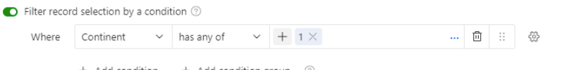

You can see that it is essentially the same thing. The *problem* that I was having (and still seem to have) is that, for a given row I can set the condition for the the Continent. If (in the example I am showing), I set the continent in the filter to "1" (which is Africa). It ABSOLUTELY WORKS well, and what I would expect. The dropdown for Countries shows the countries in Africa. That looks great!
BUT... the problem is that Airtable sets that condition for EVERY row in the Events table. So, if I then add a new row to the events table (see image below) for a different continent (Oceania in this case), when I go to the Country dropdown, it then only shows countries in Africa - which is not correct. It seems that the filter condition I put on the one row becomes global for that column (and every event added thereafter). Clearly, that is NOT CORRECT.
What I was hoping for was that Airtable had the capability to have the filter in that row be able to *dynamically* pick up the continent for that row and fill it in dynamically to the filter. In this case where it made the country column show countries in Oceania, since that's what I set in the Continent column.
That is what I could do trivially in some language such as C#, using a simple SQL statement. And I have now spent hours and hours, but I cannot see any way to do this simple substitution in Airtable. Can this be dome? Does this make sense to you?

Hmm, yeah, that's how it's set up in the base I linked, it filters dynamically based on what's selected in the "Continent" field?  Looking at your screenshots it seems like you set up the conditional filter statically instead of dynamically.  Could you try setting up your conditional filter to use a dynamic condition like the one in my screenshot?
This is yours:
This is what it it should look like:
Could you also try going into the base I linked to test the functionality to see if it's what you're looking for?
