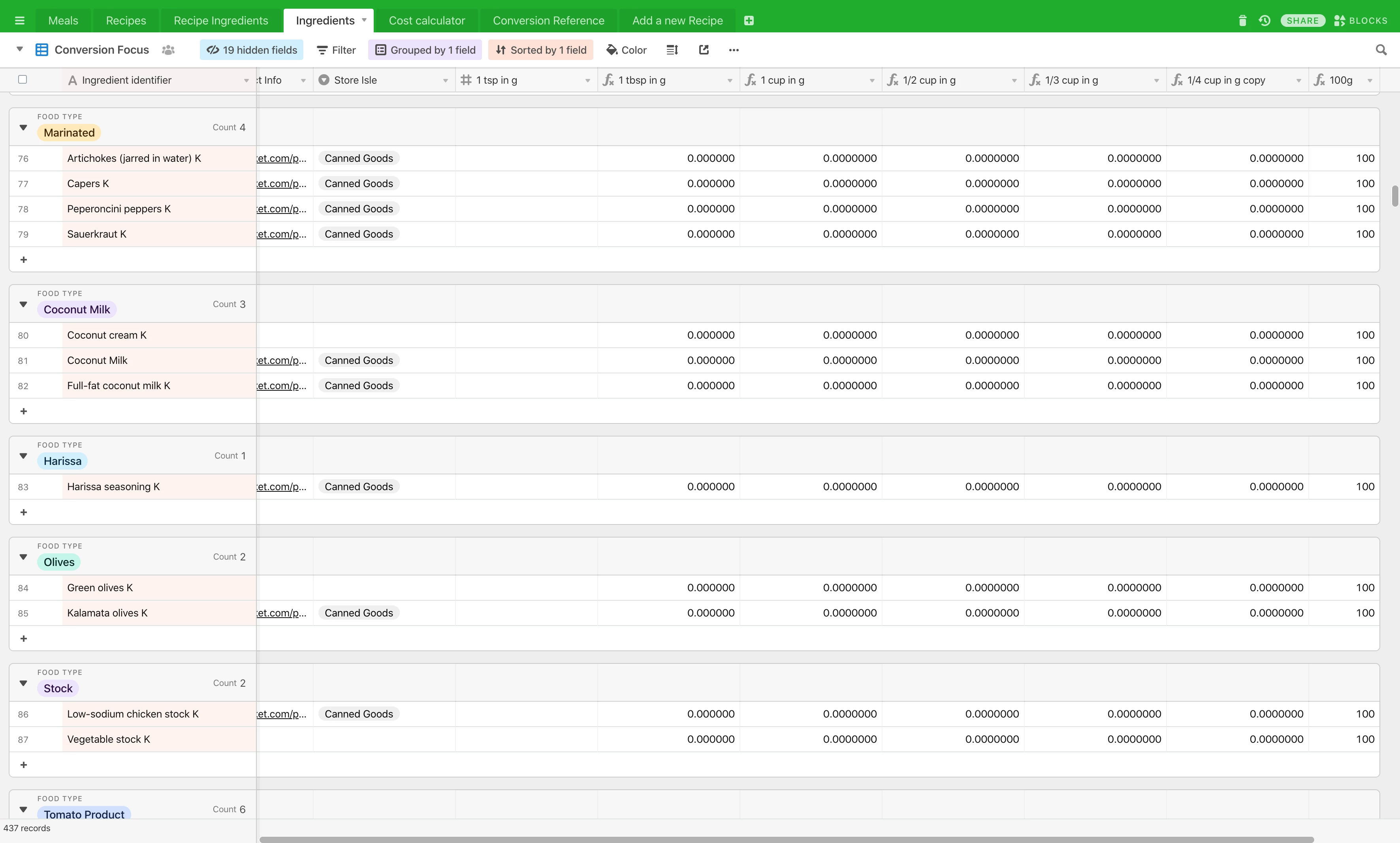

Conversion table:
So this is where I’m trying to add the nutritional value to each ingredient. The issue obviously comes in when a recipe is in cups or tbsp and others are measured in grams. I’m trying to convert all measures to grams so there’s a standard unit. Naturally, the issue comes in when 1 cup of flour obviously weighs less than 1 cup of zucchini. I’ve been manually pulling a lot of information from this database (https://www.nutritionix.com/) where they have a lot of this information so collecting the information isn’t so problematic.

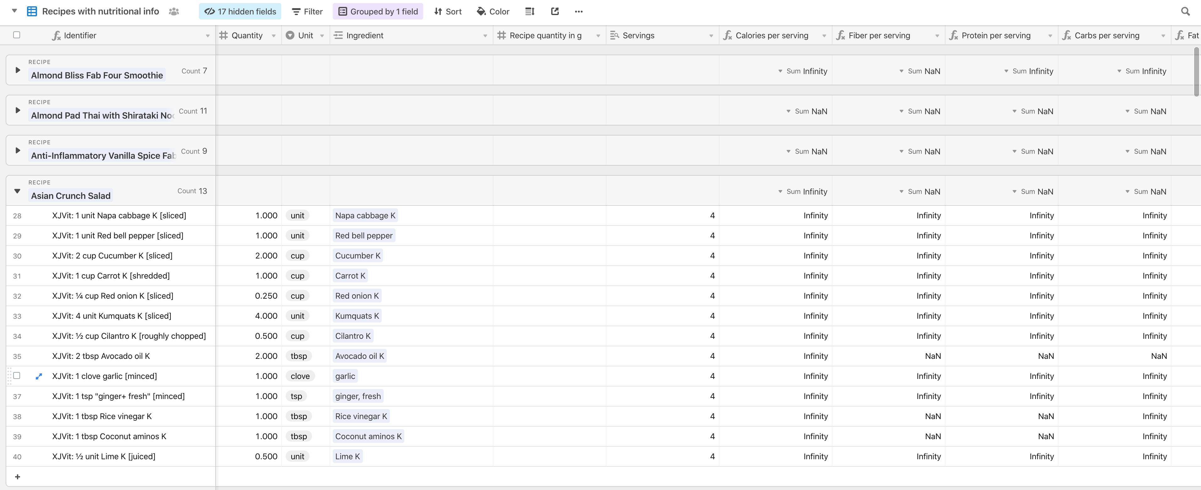

What I’m struggling with now though is in the following screenshot
I have the ingredients and their measurement, but then, in the table, how do I convert that measure into grams? Is there some way to connect the measurement info in the “Ingredients” tab to this via equation? Am I structuring the whole thing wrong?

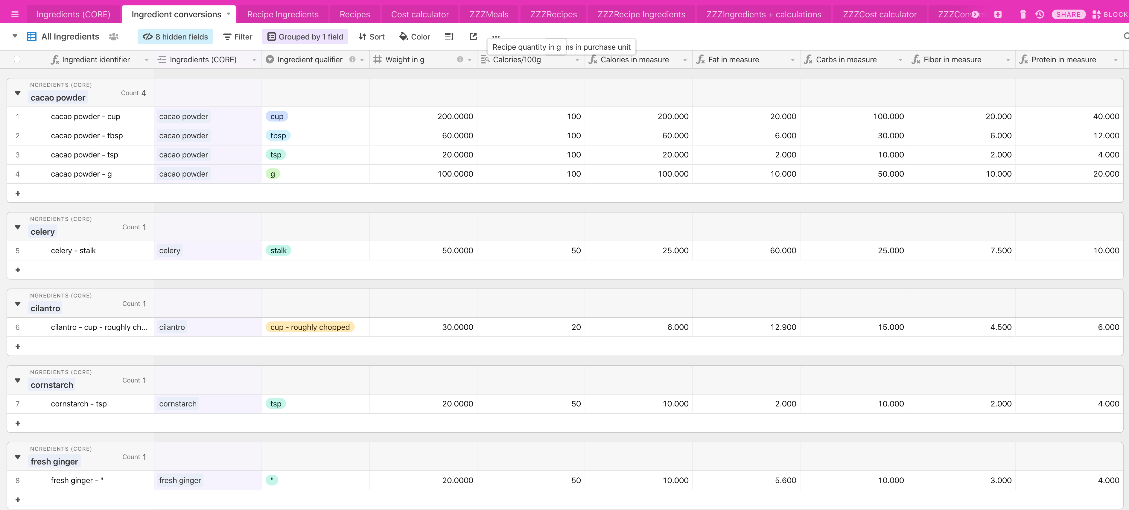

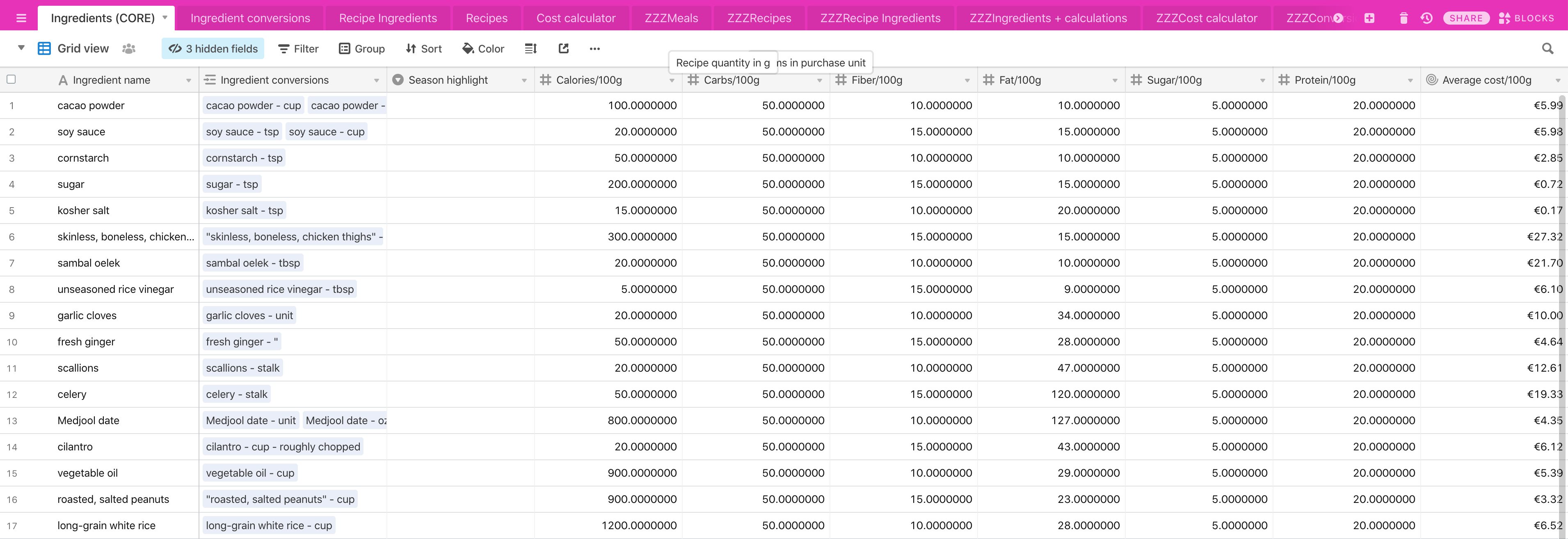

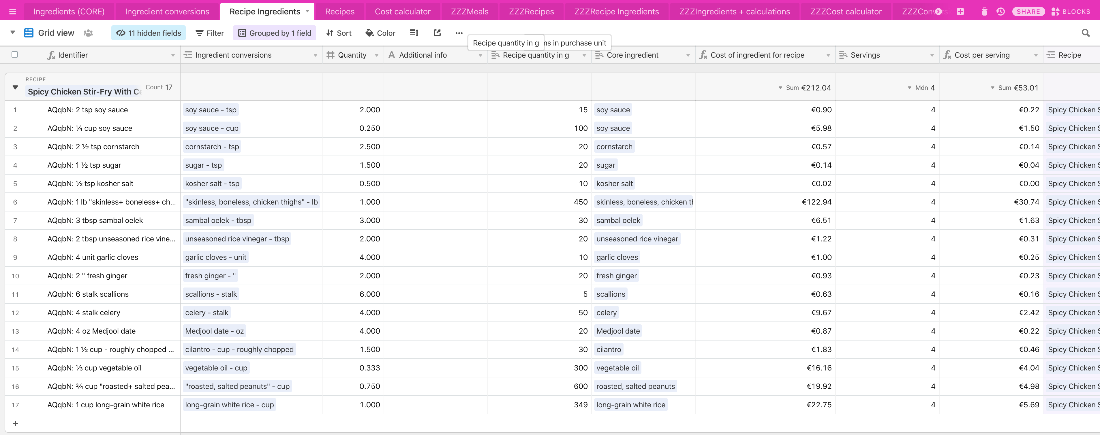

In case anyone is wondering, what I’ve done is actually added in an extra tab.
Ingredients (CORE) is just a generic list of ingredients
this links to Ingredients conversions, which is where all the magic happens. Basically what I’m doing it linking the core ingredient to it’s measured weight info. In the recipes, I’ll use the ingredients from this table as the point to calculate nutrition and cost.
Here is the bit around calculating the recipe:
Admittedly, it’s not the most elegant solution and certainly requires a lot of upfront manual work to enter the conversion info and the ingredients…but I knew that when I signed up to do this project :slightly_smiling_face:

Hi @Julia_Feld,
First, you need to have a Lookup Field that pulls the grams from the conversion table into your recipe table. The current setup you have in the Conversion table will not work, you must have each size as a record not as a field and then pull the relevant gram. Another solution would be to pull all the fields from the Conversion table to the Recipe table with Lookups, but I dont think that is a good idea.
After doing that, you can create an IF formula that changes the tbl spoon or cup to gram.
If anyone runs into a similar issue, I’d be happy to chat about my approach/some trade offs I’ve done (maybe you even have a better one!)
