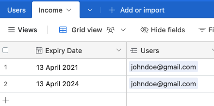

Apologies for the confusion and I appreciate your time 🙂 So, let's say I have a User's table such as the following:
USERS
First Name
Last NameEmailExpiry Date
John Doejohndoe@gmail.com
And another table called Income, where all subscription transactions are recorded:
INCOME
Paid DateEmailSubscription PeriodExpiry Date
13/4/2019johndoe@gmail.com213/4/2021
13/4/2021johndoe@gmail.com313/4/2024

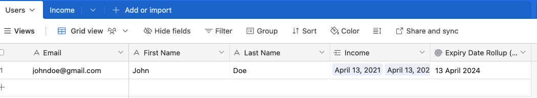

I would like column 'Expiry Date' in table {Users} to display the latest date (13/4/2024) by finding all records in table {INCOME} that match the users email address (such as the two displayed) and returning the record with the latest date MAX(values).
I guess what I'm failing to understand is how to link records, and perform a function on them such as what you would do in excel via LOOKUP and MAX().
I hope this clearly explains what I'm trying to achieve!

Ah I see!  Thank you very much for the details.  You'll just need to link up the records appropriately, then you can use a rollup field with "max(values)" to display the latest date:
Link to base
You could use an automation to keep the records linked, e.g. when a new "Income" record gets created, trigger an automation that'll look for a record in "Users" with the same email, and then link the two records together.  The rollup would then automatically update
