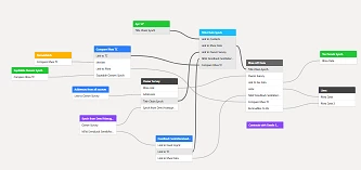

DisraeliGears01
Forum|alt.badge.img+22
Indeed this is a schema question and intentionally considering what information is where and how it relates to other information. I’d go find a whiteboard haha.
Overall Airtable doesn’t use expressed primary keys (it has recordIDs that run in the background unless you want them expressed). When it comes to linking, you would link all the tables in the base together should the data intersect, but you can use lookup and rollup fields to move data across tables without linking them together directly. For example…
Say I have a location/address table, a services table, and an organization table. Org is linked to services, services is linked to location, but Org is not linked to location. You can use lookup fields to bring say a phone number from the location table to the service table, and then from the service table to the Org table, without linking them directly.
As for reporting, that always depends on what kind of reporting you’re doing. Do you need some kind of pie charts that are automatically generated all the time for the CEO to sagely look at and nod, or do you just need to pull numbers occasionally. Regardless, Airtable is pretty flexible and adaptable, and you can rearchitect on the fly a bit
