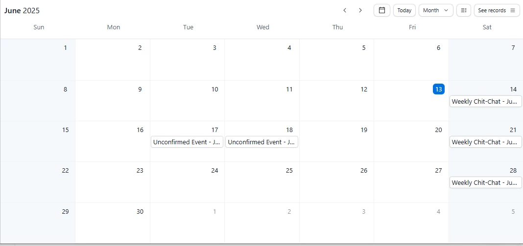

To get the calendar view looking better, you can use a Formula field like this for the primary field:
Event & " - " & DATETIME_FORMAT(Date, "LL")
Because you can make a Formula a primary field but not a Linked Record field.
And you will be able to get something like this:

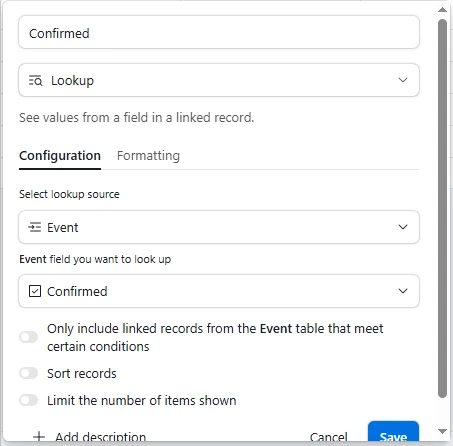

To filter the dates by events that are confirmed, you first create a Lookup field in your separate date table. The Lookup field will lookup whether the linked event is confirmed. Then, you can filter by that new Lookup field.

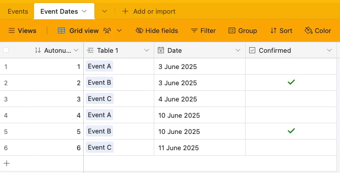

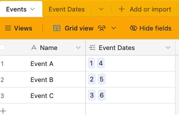

I’d recommend having one record per Event <> Date, instead of having multiple Events linked to a single Date I think:

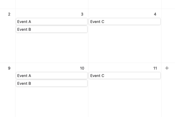

And so the calendar would look like this:

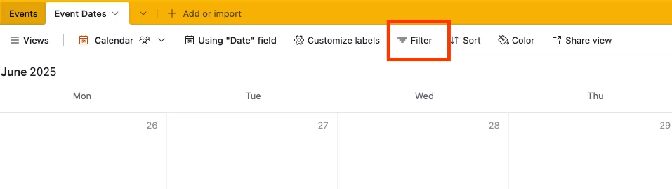

Filtering wise, try adding a filter in the Calendar view based off however your data’s set up to confirm the event date
