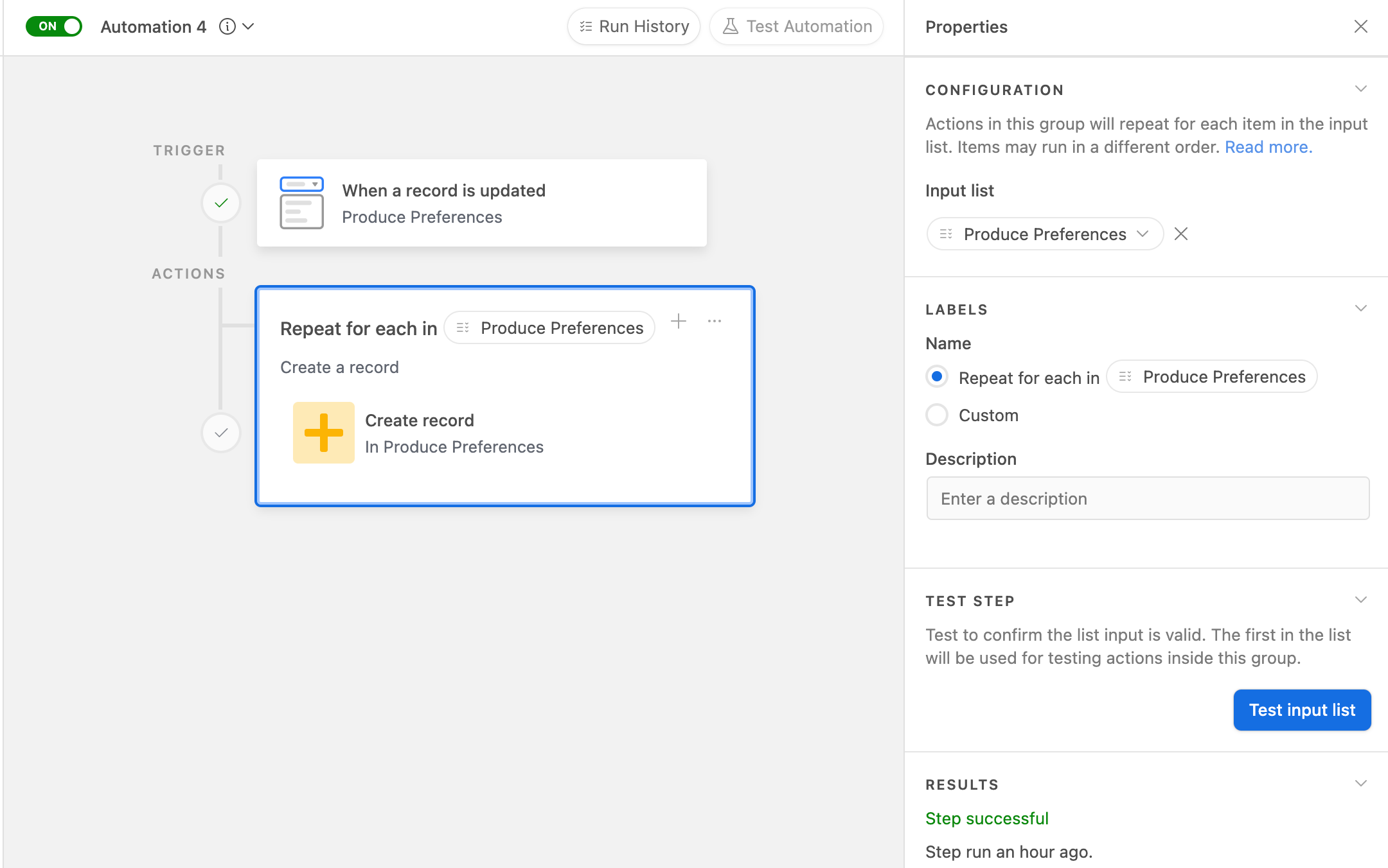

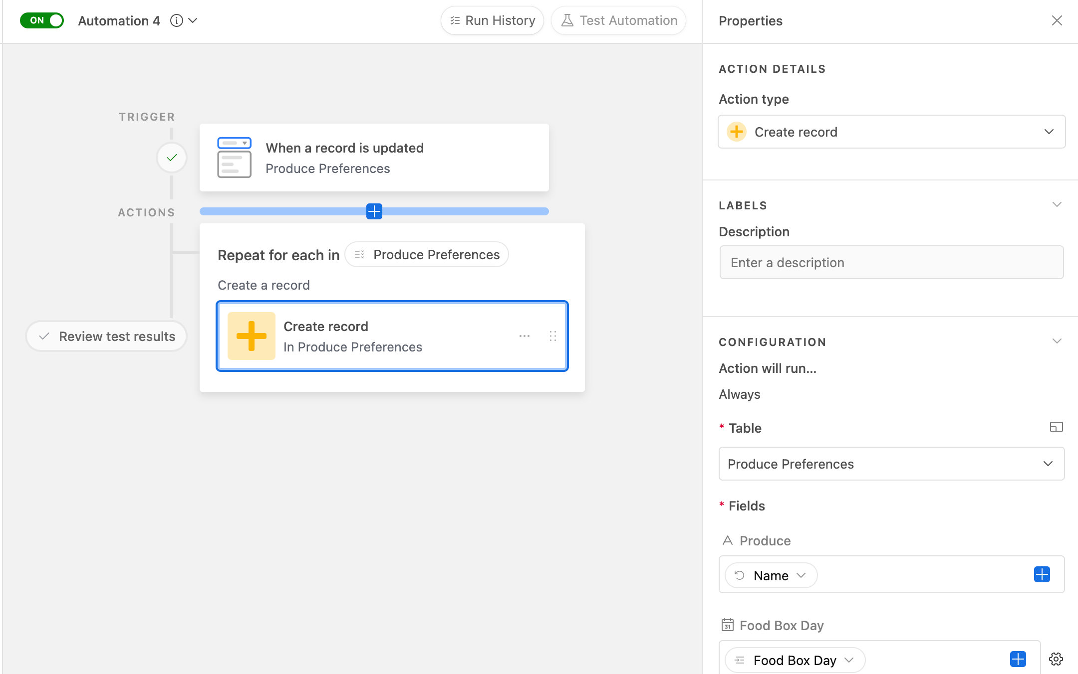

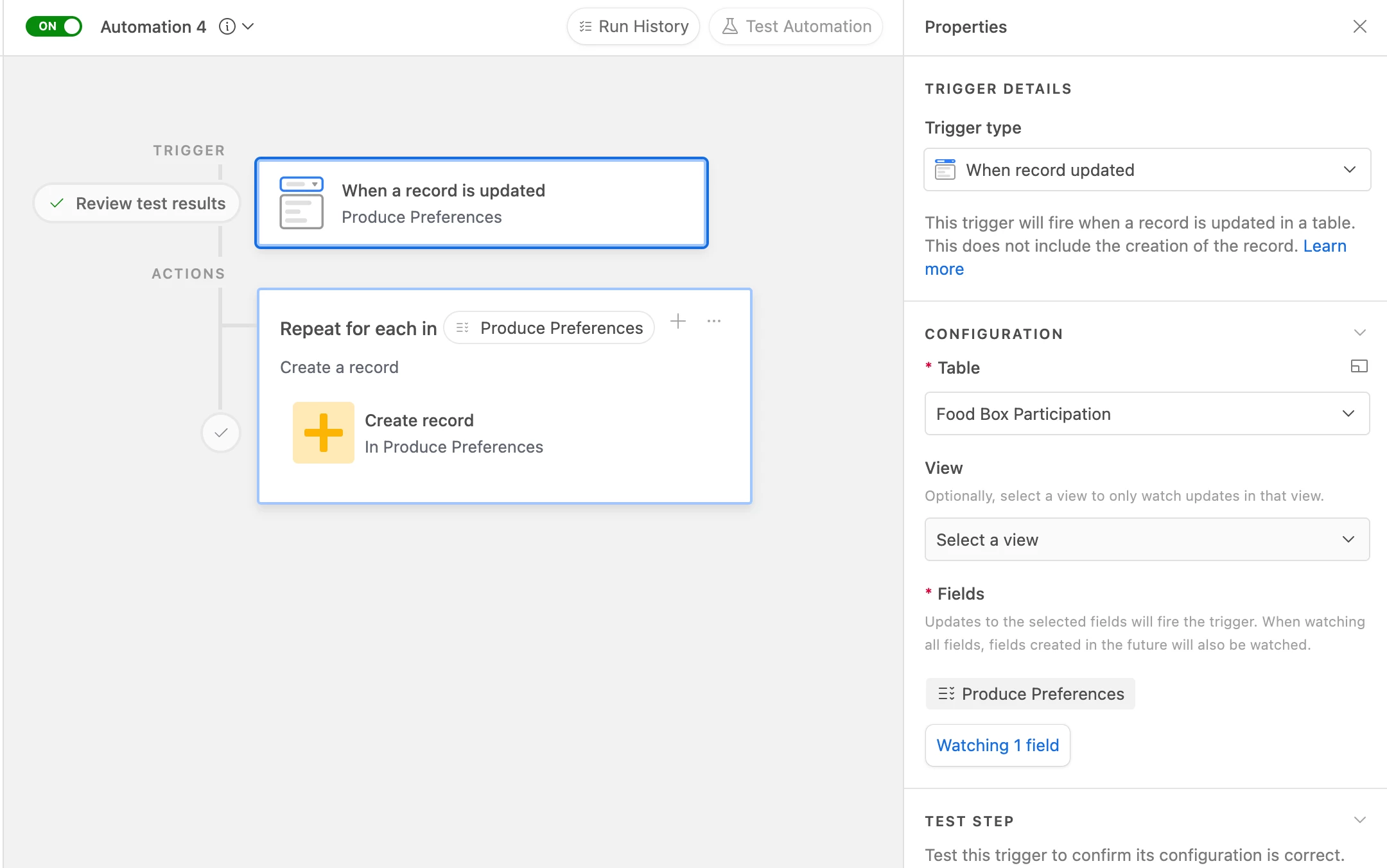

Adam, thank you so much for pointing me in the right direction! I have two follow-up questions. I've altered the "Produce Preferences" table as suggested with a field for produce and a field for date, and an automation as follows, but I'm not sure how to:
  1. Prevent duplicate records from being created in the Produce Preferences table when the Produce Preferences multiselect is updated for a second time (ie user selects a couple options in one step, but then comes back and selects another option in a second step)
  2. Delete records from the Produce Preferences table when an item is un-selected from the Produce Preferences multiselect field in the Food Box Participation table
Here are some screenshots of my automation which may be helpful:
Ah...with those complications, I would recommend you check out the workflow I created here instead.  It should solve point 1 pretty handily.
For point 2, I would attempt to solve it by creating a view that only displayed records that were linked to a record from the main data table and making the pivot table display off of that.  With the workflow listed above any deleted preferences should become unlinked and thus the pivot table should display data correctly
