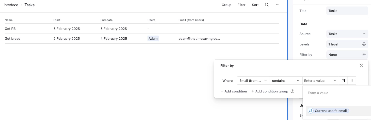

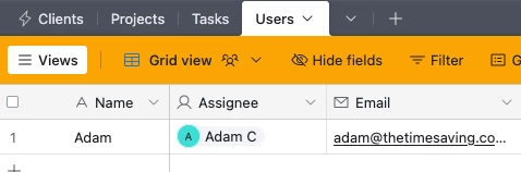

Hm I think you may need to create an ‘Email’ type field in your ‘Users’ table and populate it for that to work I’m afraid:

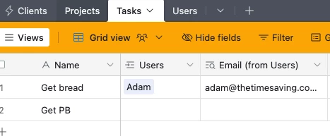

Then you’d create a lookup field to display that email:
Which would then let you filter by the email field with ‘Current user’:
