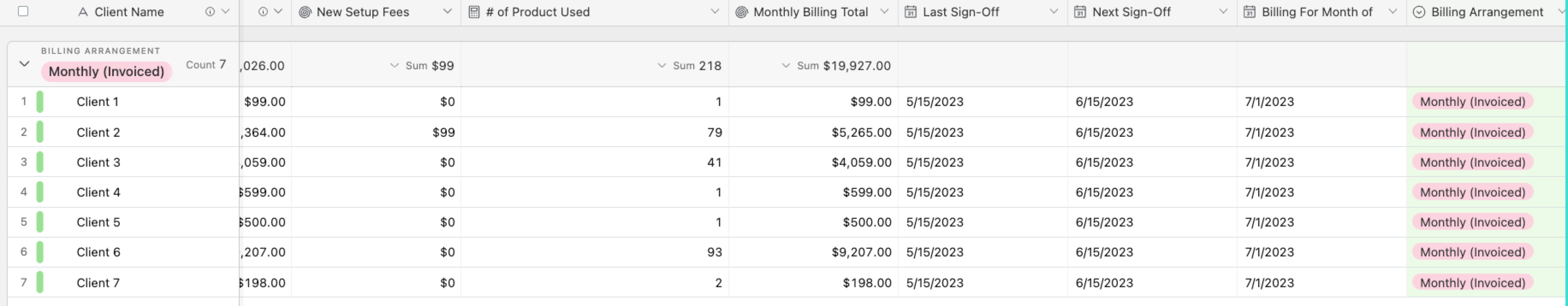

You've got it with the end result I'm looking for but one caveat - the same bill is updated each month for the next month's sign-off, so there is no new record for the bill - it's a living ledger of services our clients are using and will need to be invoiced for.  Here is a snapshot and more on the process :
1. On the sign-off date listed, I audit each client to ensure we have accurate information for what they need to be invoiced for for the upcoming month.
2. Once confirmed, these are sent to accounting to invoice each client
3. Following the sign-off, Monthly Billing Totals may be updated for the following months invoices.
4. So ideally, I would have a "Sign-off" or "Store Value" button or automation that generates a record on a separate table showing the fields
  • Record Name: "Client - Date"
  • Client Name: "Client 1"
  • Invoice Month: "July 2023" - format's not important, just showing what the period we're referencing
  • Total Billed: "$xxxx" - the amount they were billed that month.
These fields would not be impacted if I make updates to the table you see above, but just store the values at the time of sign-off.
