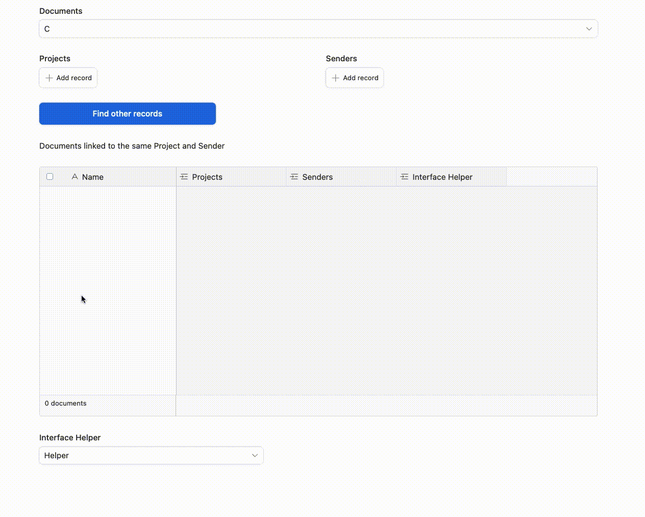

Hmm, the only way I can think of showing all the documents linked to the same Project and Sender on the same page involves an automation with a helper table:
Link to base
The idea is that you set the Sender and Project for that Document, then when that button is clicked an automation runs that'll look for any Document records with the same Sender and Project, and link it to a helper record.  That helper record is always selected via a Record Picker element within the same Interface, and we add a grid element to display all the linked Document records to it
The downsides to this are that:
1. It's kinda clunky
2. Only one person can really use this system at a time
3. You'd need to click it every time you were identifying a document
4. When you identify a new document and haven't set any project or sender, it'll be displaying the related Document records to the previous Document you identified and triggered the automation for

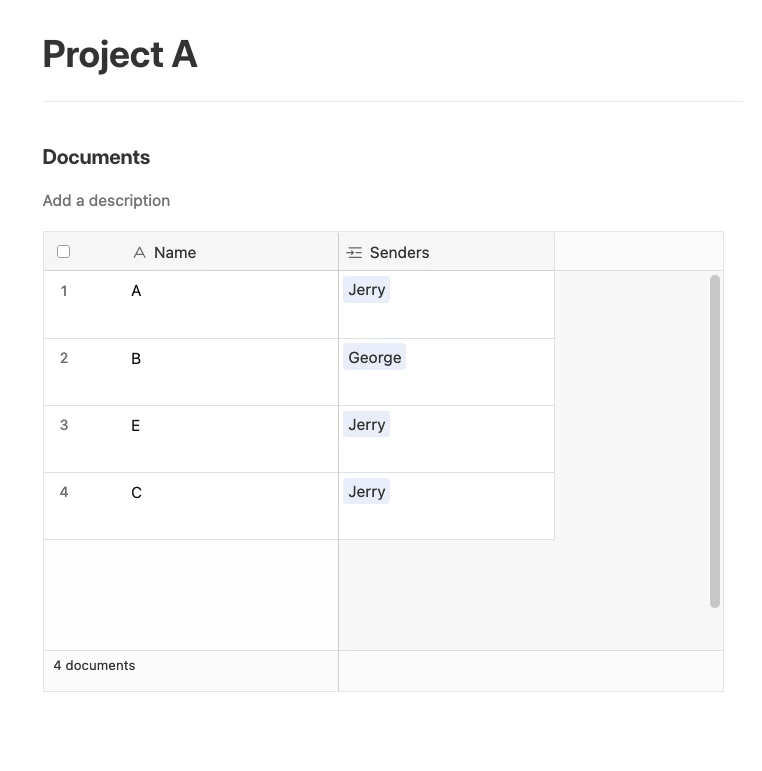

If you're okay with your worst case scenario of only showing documents from the linked Project and not showing it on the same page, you could just dump a Grid into the record details though, which seems far simpler at the expense of seeing everything instead of only the ones related to this sender:
Showing everything on the same page would require you to add some kind of record picker element to your Interface I think, which means that you'd need to link the Project once, and then select that project again via the record picker element so that you have a Grid element showing all the documents linked to that Project.  Just using the record details popup seems easier imo
