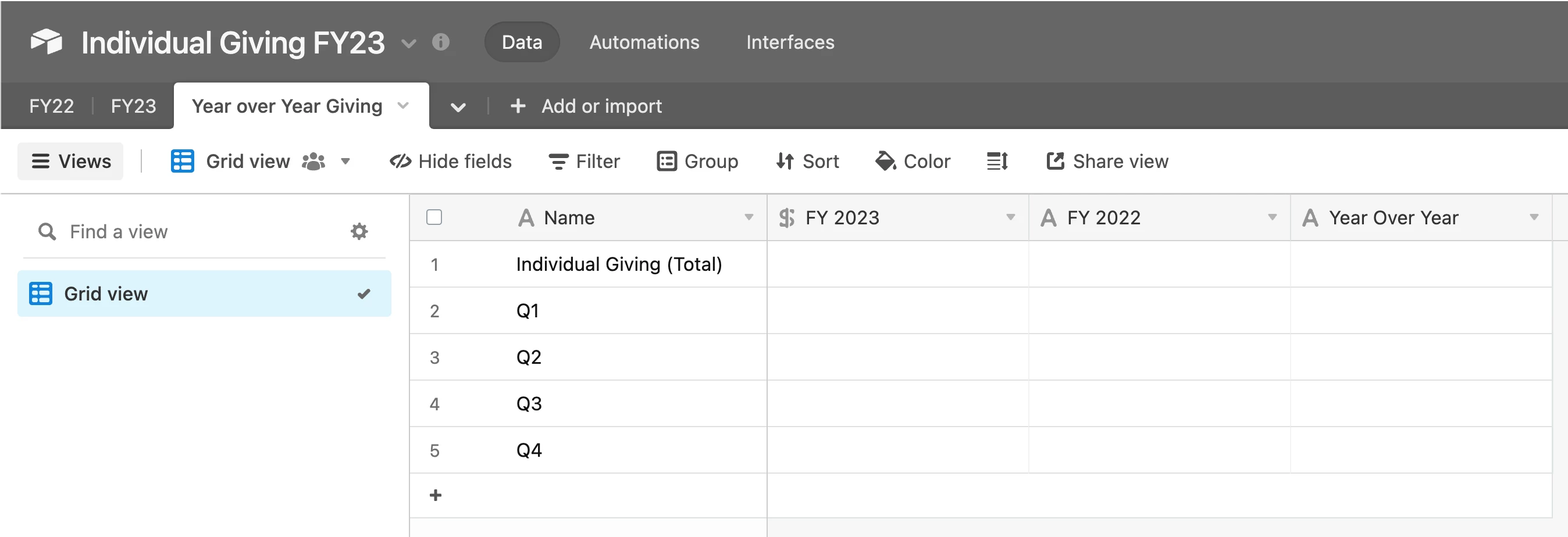

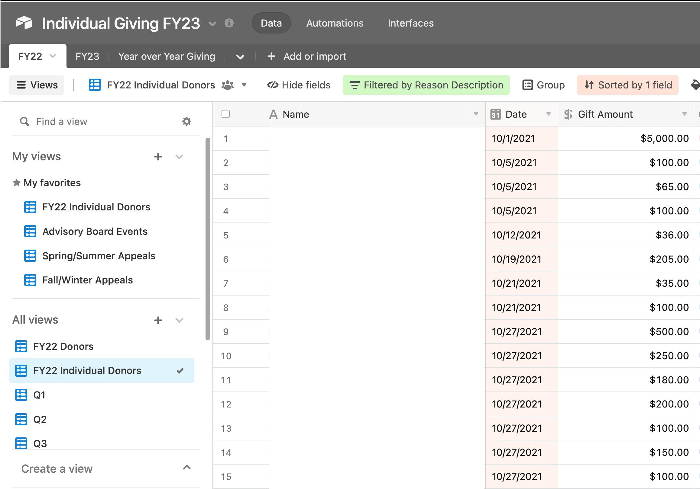

I made a base to better track and manage nonprofit donations. I have 2 tables set up: 2022 and 2023, with a third table I want to use as a summary table. Each table has a donor name, gift date, and gift amount, among other irrelevant information, as well as views broken down by quarter.
What I am looking to do, is have that third table list the total gift amounts and the total by quarter as I have it in my views. I've been trying to look up formulas but nothing seems to work.
I tried linking but all that does is create 2,000 new rows in my summary table, which I don't want. I just want to take the total it presents me, and plug it in here so I can summarize the data, and compare to last year's data.

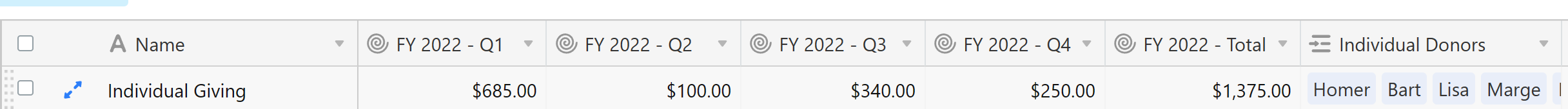

It sounds like all you'd need in your Summary table is a single record that links to ALL the donation records which can then roll up the data how you want. Here's how I think that can look.

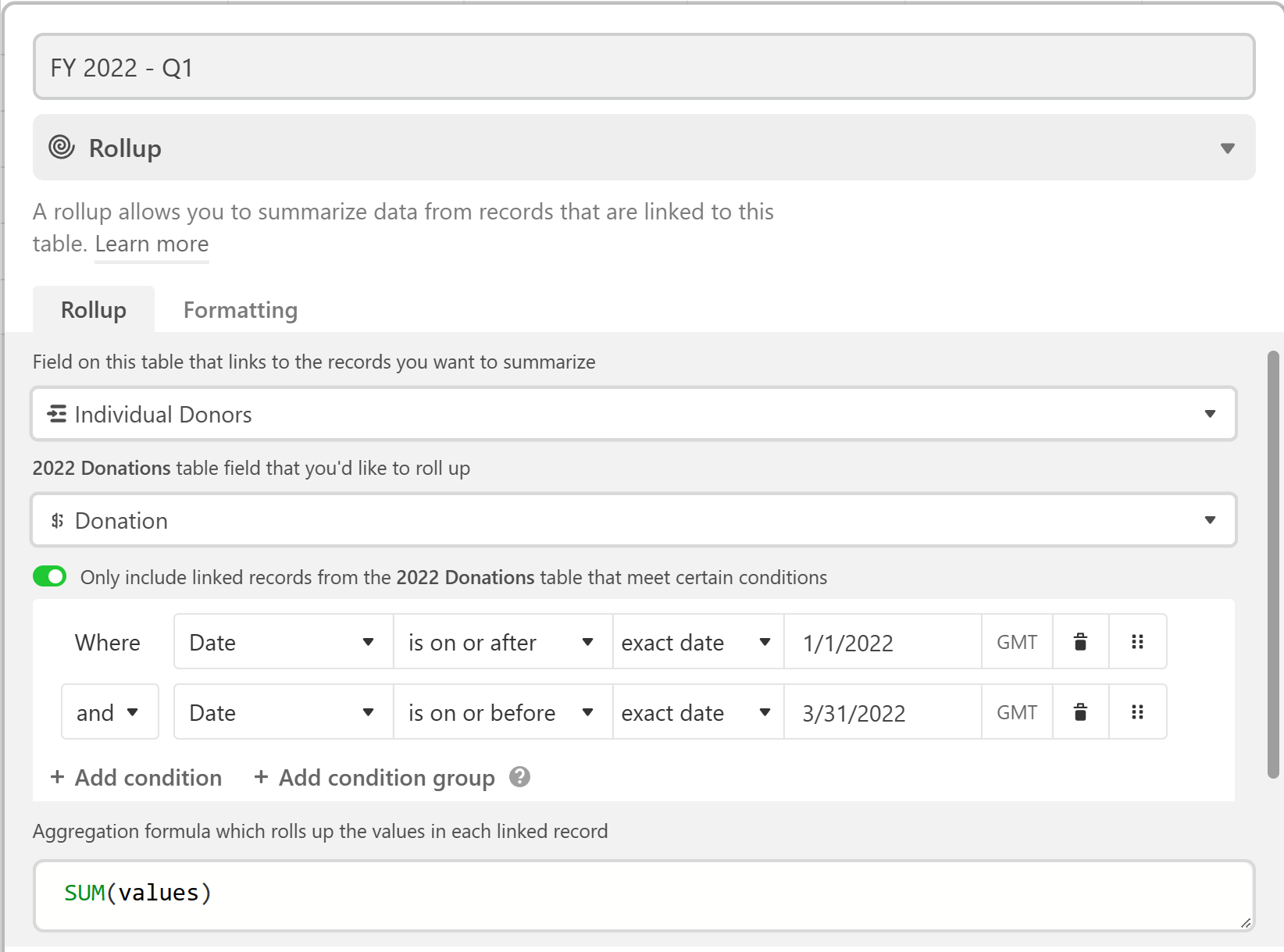

Below is a screenshot of how I set up the Rollup field for the quarter breakouts. It's easy to set up manually and won't take long since there are only 4 a year, but there are ways to automate this if you want as well.

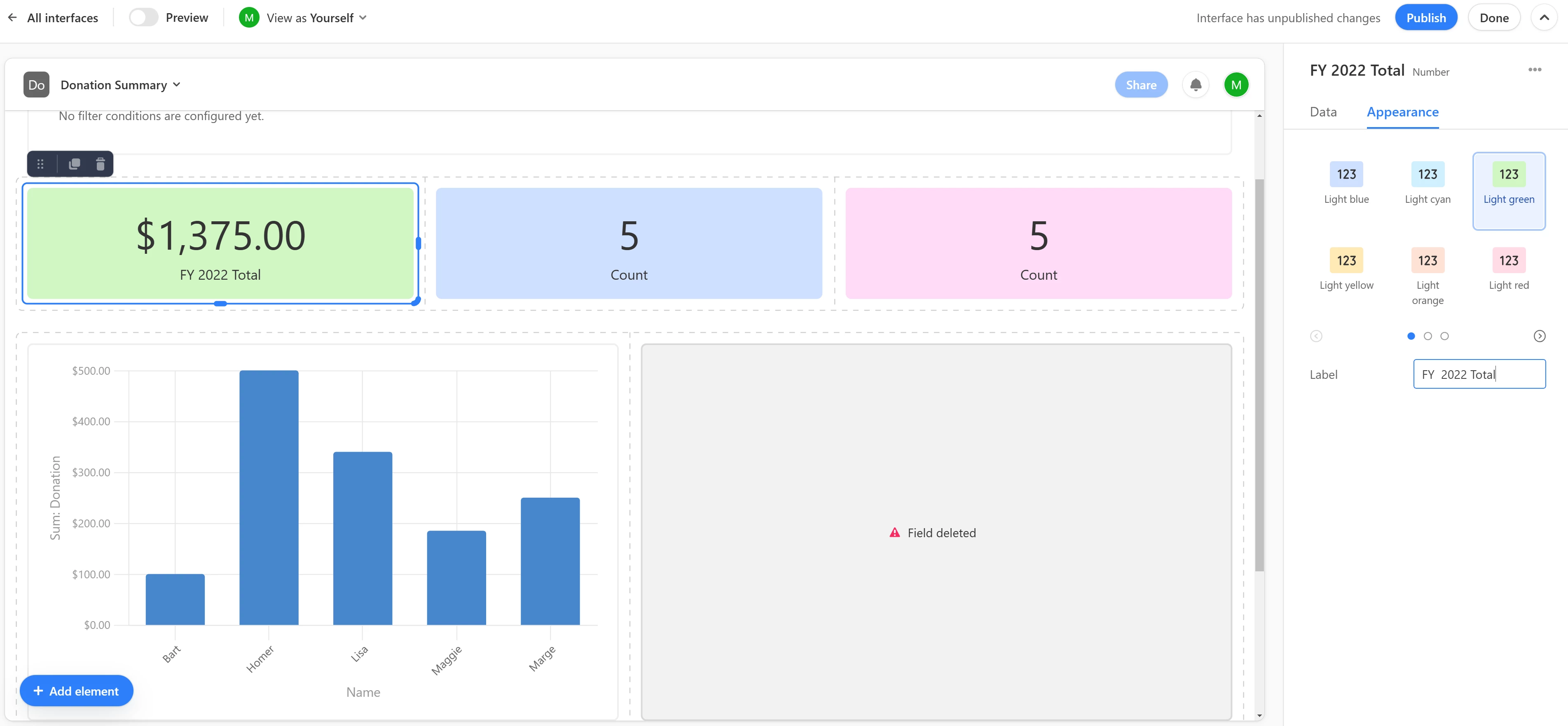

If all you truly want is a high-level summary, maybe you can even create a dashboard using an Interface. You'll be able to add a filter that lets you tweak the results live based on criteria making it a much more dynamic experience. But again, that's all personal preference.
Airtable has Interface templates. This is how far I got after just a minute or so of modifying the Interface template.

I separated by year because I didn't want to have a long list of views I'd have to scroll to get to info I need. I wanted things separate. The part that trips me up about the rollups is, when I try the linked fields, all it does it make 2,000 new rows in my "Year over year" table, and doesn't list all the donors in a single cell like you have it.
I have tried some interface stuff but it still seems limited as the two tables can't be linked there. I can have displays of fields from only one source, which is really counterintuitive.
