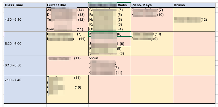

Nonetheless, here’s a screenshot of the sample redacted timetable:
I think you’re suggested opposite axis might work better for airtable.

Interesting!
In this screenshot, each redacted name is a student’s name? What does the number in brackets represent?

Yes, redacted name is student name, number is age. PM’d you there.

Got it. I’ve thrown something together here that I think would get you that screenshot you shared
Form
Changes need to be made for the workflow of course, you’d probably want to allow users to select the instrument and then only display classes for that instrument and such, but broadly it’s there
