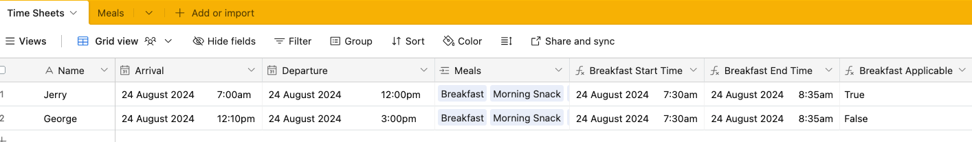

Hmm, if the meal timings will never change, it might be easier to have the meal timings within the Time Sheets table instead
If the meal timings do change and you want to keep a historical log of whether a specific child on a specific date qualified for that day's meal timings, then yeah keeping it in a separate table would make sense, and you'd need to link the 4 meal records to every "Time Sheets" record (probably via an automation), and then create lookups to grab the start and end times for each meal
Formula wise, you'd need to parse those times for the arrival day, and use combinations of IS_BEFORE, IS_AFTER and IS_SAME to figure out whether they're applicable for that timing
The formula gets pretty involved, and here's my attempt at it
Link to base 
IF( AND( OR( IS_SAME( {Breakfast Start Time}, Arrival, 'minutes' ), IS_BEFORE( Arrival, {Breakfast Start Time} ) ), OR( IS_SAME( {Breakfast End Time}, Departure ), IS_AFTER( Departure, {Breakfast End Time} ) ) ), "True", "False" )
