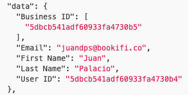

I can also expand the “sent request” field and get this (this is the first row of my data in my Parabola table)
  "data": {
    "Business ID": [
      "5dbcb541adf60933fa4730b5"
    "Email": "juandps@bookifi.co",
    "First Name": "Juan",
    "Last Name": "Palacio",
    "User ID": "5dbcb541adf60933fa4730b4"

I’m pretty sure the issue is this data payload -
Doesn’t a post require an array of records and a fields node?

Hi Bill :wave: Thank you for your response. Thanks for the tip. That made it work. Have you had success with exporting in linked records? I get this error on Parabola. Confirmed that the record does indeed exist.
  "error": {
    "message": "Value \\"5dbcb541adf60933fa4730b4\\" is not a valid record ID.",
    "type": "INVALID_RECORD_ID"

That ID in the error is not a record ID. It means your code is not passing the right ID.

Oh got it! Thanks. Turns out “linked” columns in Airtable don’t use the user defined value to identify the record. They use the auto-generated Record ID.
