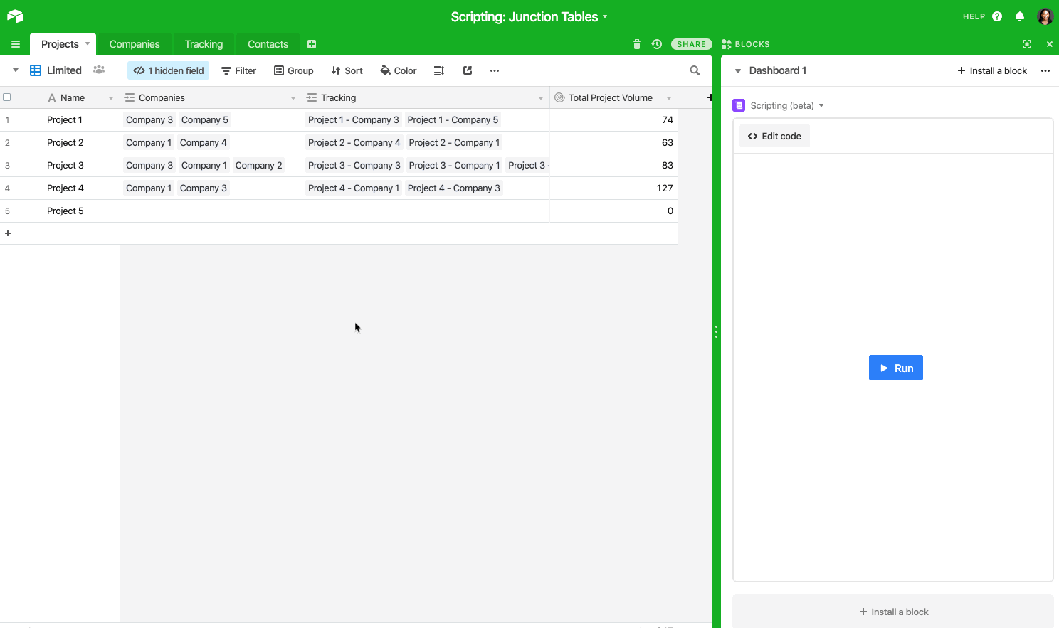

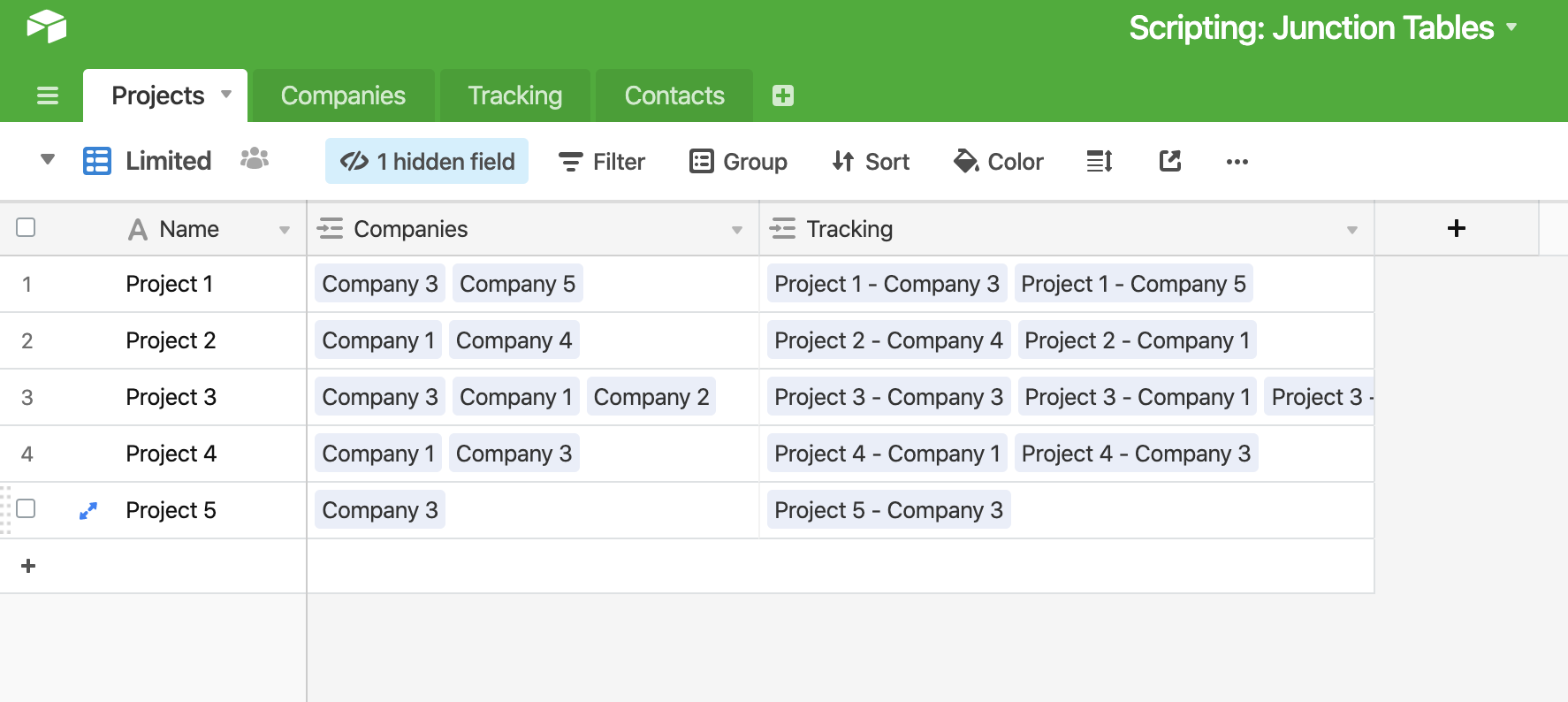

If you have a many-to-many relationship, chances are you have a junction table. And chances are, setting up and maintaining that junction table is probably…not your typical idea of a fun time.
Welp, now it can be! Thanks to some serious help from @Stephen_Suen, we figured out how a script could help us automate this process. In the below example I have a list of projects, and for each project I’ve assigned multiple companies to it. I also have another table named “Tracking” where I track all the details related to a specific project-company pair.
Previously to create that junction, I had to do a lot of finagling, which took a fair bit of time. However, with a script, I can automatically create the records I need. Below I’m going to assign companies to Project 5, and then use a script to create the junction records.
Ahh, the joy of automation. :massage_woman:t5: Thank you @Stephen_Suen! Script below. Example base here.
let projectsTable = base.getTable('Projects');
let projectQuery = await projectsTable.selectRecordsAsync();
let projectRecords = projectQuery.records;
let companyTable = base.getTable('Companies');
let companyQuery = await companyTable.selectRecordsAsync();
let joinTable = base.getTable('Tracking');
let joinQuery = await joinTable.selectRecordsAsync();
// Go through all the records in the projects table
for (let projectRecord of projectRecords) {
    output.markdown('#### Checking project: ' + projectRecord.getCellValueAsString('Name') + '...');
    // For each project, get the linked company records
    let companyRecordsLinkedToProject = projectRecord.getCellValue('Companies');
    // For each project, get the linked join records
    let joinRecordsLinkedToProject = projectRecord.getCellValue('Tracking');
    if (joinRecordsLinkedToProject === null) {
        // If there are no linked join records, use an empty array instead
        joinRecordsLinkedToProject = [];
    // Create a Set of company record ids that are linked to the project.
    // A Set is like an array, but more efficient.
    let companyRecordIds = new Set();
    for (let linkedCompanyRecord of companyRecordsLinkedToProject) {
        companyRecordIds.add(linkedCompanyRecord.id);
    // Loop over all join records linked to the project.
    for (let linkedJoinRecord of joinRecordsLinkedToProject) {
        // Get the full join record, not just name and id
        let joinRecord = joinQuery.getRecord(linkedJoinRecord.id);
        let companyRecordLinkedToJoin = joinRecord.getCellValue('Company')[0];
        let companyRecordId = companyRecordLinkedToJoin.id;
        // Remove this company record id from the Set.
        output.text('Join record already exists for company: ' + companyRecordLinkedToJoin.name);
        companyRecordIds.delete(companyRecordId);
    // Now we have a Set of company record ids that don't have join records.
    for (let companyRecordIdToJoin of Array.from(companyRecordIds)) {
        // Create the join record linking this project and this company.
        let companyRecord = companyQuery.getRecord(companyRecordIdToJoin);
        let companyName = companyRecord.getCellValueAsString('Company Name');
        output.text('Creating join record for company: ' + companyName);
        await joinTable.createRecordAsync({
            'Project': [{id: projectRecord.id}],
            'Company': [{id: companyRecordIdToJoin}],
    output.text('\n');
    output.inspect(companyRecordIds);

I’ve updated the base and script to check for changes in the Projects table. So if you remove someone from a group in the Projects table it’s reflected in the Junction Table. Just add this bit to the end of the script.
// Get Join Records Now that the Script has Run
let joinQueryTwo = await joinTable.selectRecordsAsync();
let joinRecordsTwo = joinQueryTwo.records;
let nonMatches = joinRecordsTwo.filter(c => !c.getCellValueAsString('Project Lookup').split(', ').includes(c.getCellValueAsString('Company')))
// Delete Irrelevant Records Now that the Script has Run
await joinTable.deleteRecordsAsync(nonMatches)
I just noticed that if your Project name has commas in it, the junction record gets deleted when you add this last piece of code.
The corresponding junction record is added to the junction table with quotes, and then it gets deleted.
the solution to avoid this would be to remove or replace commas. could this be included in the code?
