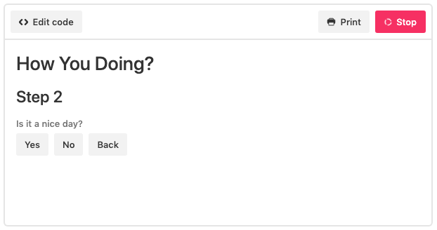

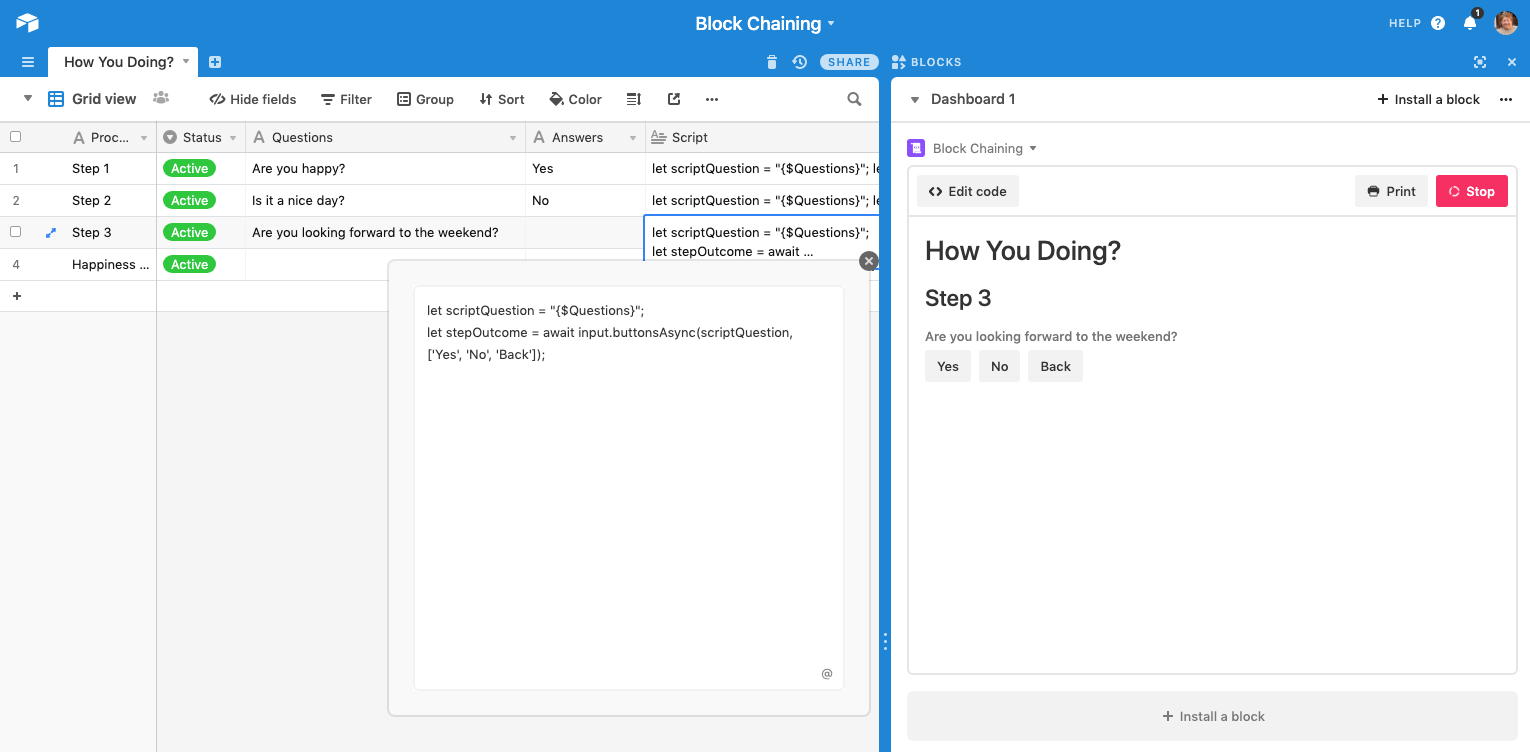

Imagine a three-step process asking basic questions about your day. It’s a survey per-se and I’ve embodied the essence of it into a simple table shown below. Each step has a question and a column for answers. Lastly, there’s a final step - Happiness Assessment - that computes your relative happiness based on your answers
The following screenshot shows this three-step process but also displays a very important field showing Block Script in a long text field.
As I mentioned, each step is a question, and each question is presented abstractly in the script using the value in the first column (i.e., Process Step). The final stage in the process is based upon the answers at each step in the survey process.

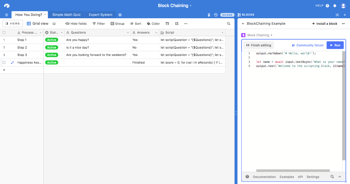

BlockChaining
To do this elegantly and well, chaining together different script blocks is ideal.
Each script in each process is loaded and executed sequentially. A single “runner” Block orchestrates the execution of each data-based block and it manages the in-memory scope of the results from start to finish.

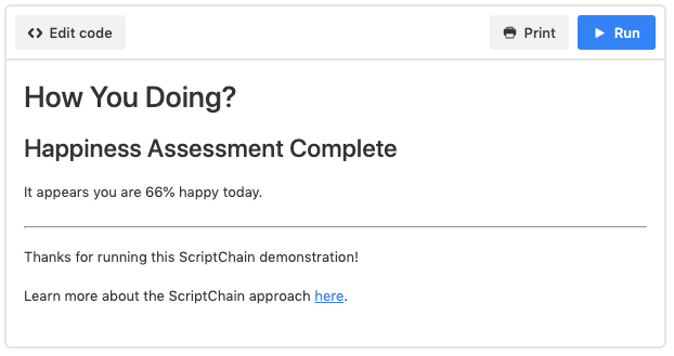

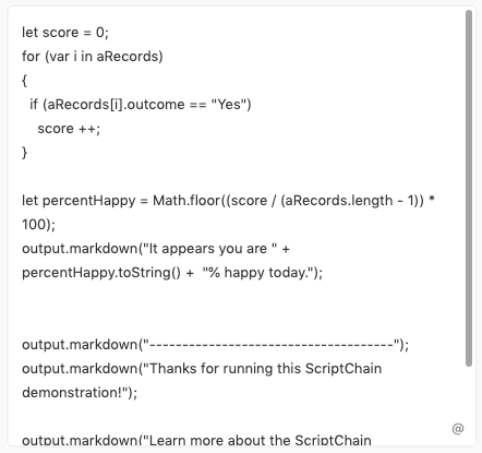

The final step includes the block shown below which displays the resulting happiness assessment. Note the reference to aRecords - this is the variable that contains all of the answers gathered from each of the chained blocks.
And the outcome in the block runner reveals this display when all four steps have completed.

Do I understand correctly that you are executing JavaScript which is stored in a field of a table by querying that record and retrieving the JavaScript out of the record’s field?
Bill_French
Yes. The block runner retrieves and executes script blocks from the table itself. I also have tested block script served from Apps Script services.
