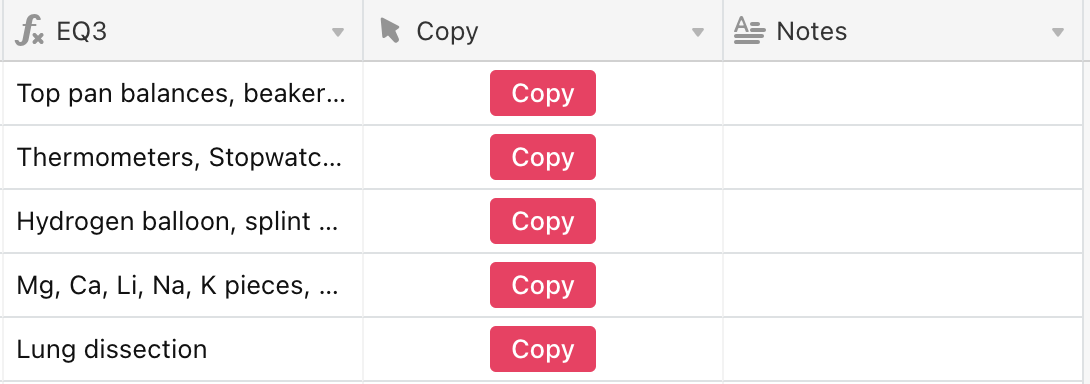

I’m learning how to use the scripting block, not too successfully. I have tried to adapt the scripting block “select a record” and one from the thread about linked fields from @capt & @JonathanBowen but I can’t seem to get it to work. I am trying to copy the text output by a formula field (EQ3) into the text field Notes using a button.
Any help or advice would be much appreciated!

Thank you!
By adding both of these things in the script now works runs properly - thank you!
The button still currently applies to all records regardless of whether or not EQ3 is populated, do you know how it is possible to change this?

No, it is not currently possible to change this. You can write your script to detect whether the field is empty and product different output when it is.
