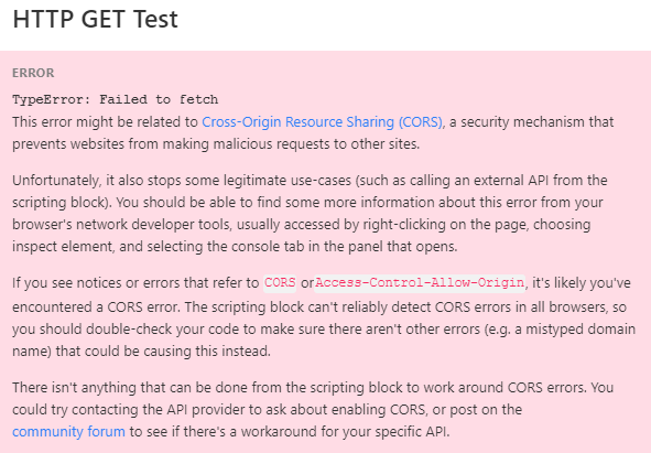

Hi @Bill.French,
thanks for your reply! I just tried it out (only replaced gcpUrl with my test domain ‘https://stefan.kunzweb.net/’ and now get the following error message on script execution:
Thanks, Stefan
Bill_French
CORS…
This is unfortunate and the best advice is to start here to get a basic understanding of why CORS issues arise. In a nutshell, the response is an indication the server you are requesting content from is not entirely comfortable (security-wise) with such a request coming through something other than a browser (i.e., a javascript-based request).
One would think a GET request in javascript is no different than a web browser making the same request. But this is not the case; there are more complexities that arise as compare to a browser.
Backing up a bit - is your concern to test the URL …
  1. To be certain it is a web page that actually functions?
  2. To be certain that the URL is really a valid URL?
  3. To fetch data from the target URL?
  • March 22, 2020

Thank you @Bill.French! Yes, this is unfortunate. I have tested the call with different URLs (e.g. also with Wikipedia) but I always got the CORS error.
Never mind - it is not a critical task and I can use other solutions outside of Airtable to solve that based on exported Airtable data. My intention was just to make sure that all URLs which I have in my DB are still valid, i.e. to be alerted if a URL is no longer existent, e.g. becuase it has moved to a different location. I don’t need to fetch any data from it.
Thanks, Stefan
