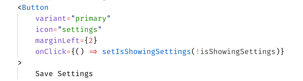

I tried that too, @Stephen_Suen:
But I got this error:
ReferenceError: setIsShowingSettings is not defined

Do I need to pass the setIsShowingSettings() function as a prop into the SettingsMenu component? (And if so, what does that look like?)
If the state lives in the parent component of SettingsMenu, then you’ll need to pass the setIsShowingSettings function down as a prop.
Here’s an example:
function Block() {
    const [isShowingSettings, setIsShowingSettings] = useState(false);
    useSettingsButton(() => {
         setIsShowingSettings(!isShowingSettings);
    if (isShowingSettings) {
        return (
            <SettingsMenu
                onSaveClick={() => {
    } else {
        // Render your block
        return 'Hello world!';
function SettingsMenu(props) {
    return (
        <div>
            {/* Render settings */}
            <Button
                variant="primary"
                icon="settings"
                marginLeft={2}
                onClick={props.onSaveClick}
                Save Settings
            </Button>
        </div>
