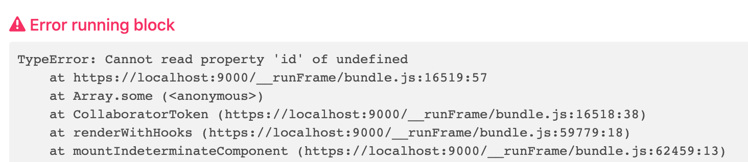

I’m using the CollaboratorToken component:
but getting an issue. This works:
<React.Fragment>
  {base.activeCollaborators.map(choice => (
    <div>
      <p>{choice.id}</p>
      <p>{choice.name}</p>
      <p>{choice.email}</p>
    </div>
</React.Fragment>
but the code in the docs is giving me an error:
<React.Fragment>
    <CollaboratorToken
      key={choice.id}
      choice={choice}
      marginRight={1}
</React.Fragment>
Any pointers on this one? I’m importing CollaboratorToken, useBase so think all is good there.
Thanks!
Best answer by Kasra
Sorry, there’s a typo in the example in the documentation. The prop to the CollaboratorToken component should be collaborator, not choice:

Forum|alt.badge.img+14
If you look closely at the sample code, the key assignment uses collaborator.id instead of choice.id. That should work, even though I can’t tell where collaborator is being defined. Perhaps there’s some magic going on in the <CollaboratorToken> component.
JonathanBowen
  • June 6, 2020
Yeah, I should have said, this doesn’t work for me either unfortunately
  • June 9, 2020

Hi @Kasra - great, thanks for this, will try it out.
  • June 9, 2020
We’ve fixed the typo in the docs, thanks for reporting this!
