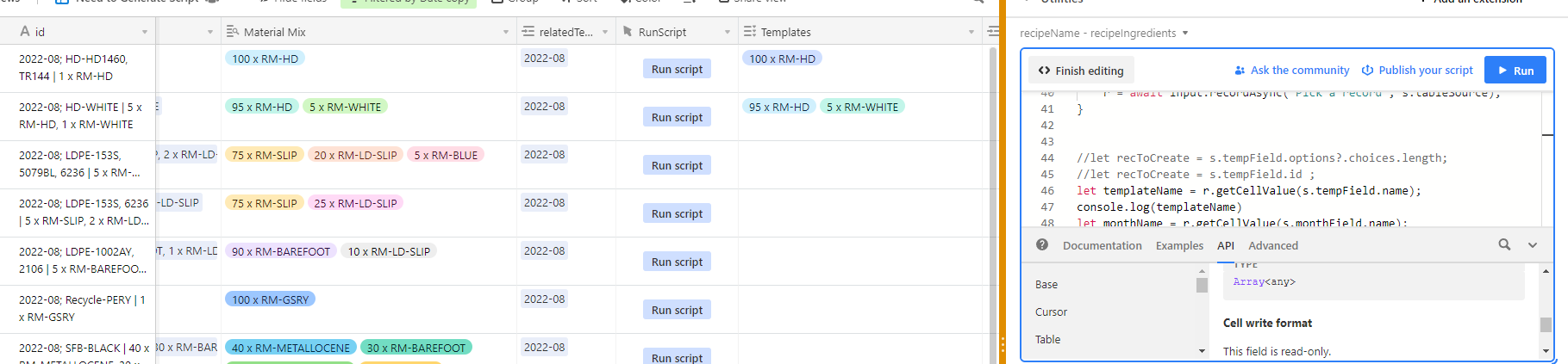

Previously I’m using multiselect field from the current table. However, I am trying to automate by pulling the multiselect field from the LOOKUP. But when I want to run the script, I am unable to do so.
Here is the structure of the base
My current script

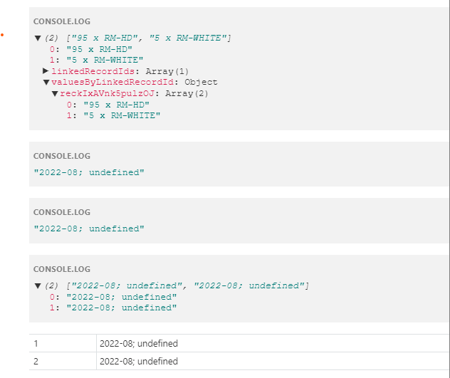

let templateName = r.getCellValue(s.tempField.name);
console.log(templateName)
let monthName = r.getCellValue(s.monthField.name);
templateName.forEach(item => console.log(`${monthName}; ${item.name}`));
let combinedArray = templateName.map(item => `${monthName}; ${item.name}`);
console.log(combinedArray);
output.table(combinedArray);
How to modify this script? Thanks!
Best answer by Alexey_Gusev
try to add .join().split(',')
right after getCellValue(fname)
i’m not sure it’s correct for all types of lookup, but it should work in your case
note that if your values contain comma, you should define another divider, also providing join() with it

You’re a lifesaver! Thanks a lot mate!
