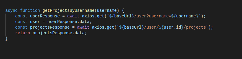

This article should provide the insight you’re looking for:
Getting to know asynchronous JavaScript: Callbacks, Promises and Async/Await...
Introduction
Reading time: 11 min read
