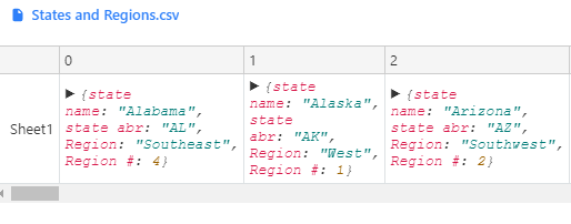

This is the output table I get with an csv I upload:

Your script works for me! There’s something fishy about the output in your
original post: it includes a cell with the text “Sheet1”. A “sheet” is a
concept in a spreadsheet file (which normally has a filename like .xls or
.ods); CSV files don’t have sheets.
I had the same thought, I’ve never seen a sheet number come up when uploading a CSV anywhere.

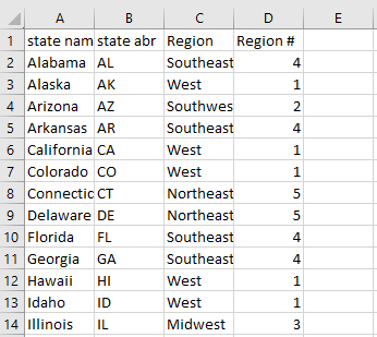

I don’t think file uploads are permitted through this site (I at least don’t see it, I could be missing it) but now that I know it’s not the script, I attempted the same script with other CSVs I had lying around and got the same result. Most of these CSVs have been converted from .xlsx or .xls file types.
It sounds like you’re right about something happening quietly that ends up in a format that Airtable doesn’t expect.

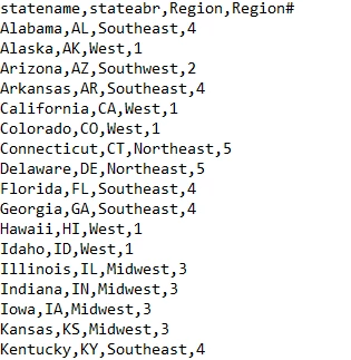

I’m not sure if this is particularly helpful but here’s a screenshot of the CSV text:

There are some small differences between the data in the second and third screenshots, but it doesn’t look like any of them are significant here.

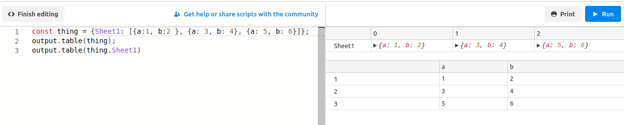

Working backwards from your first screen shot, I have some guesses about the
structure of the parsedContents object. It may be that if you access the
Sheet1 property, you’ll see the output you’re after:
