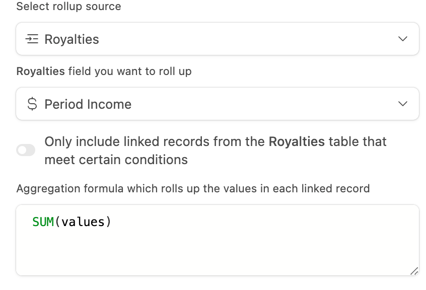

It is a type of formula field specifically for linked records.  It is called a rollup field.  The rollup uses the SUM(values) formula for all of the records linked in the royalties field.  It is summing the royalty â€ƒpayment field from the royalties table.

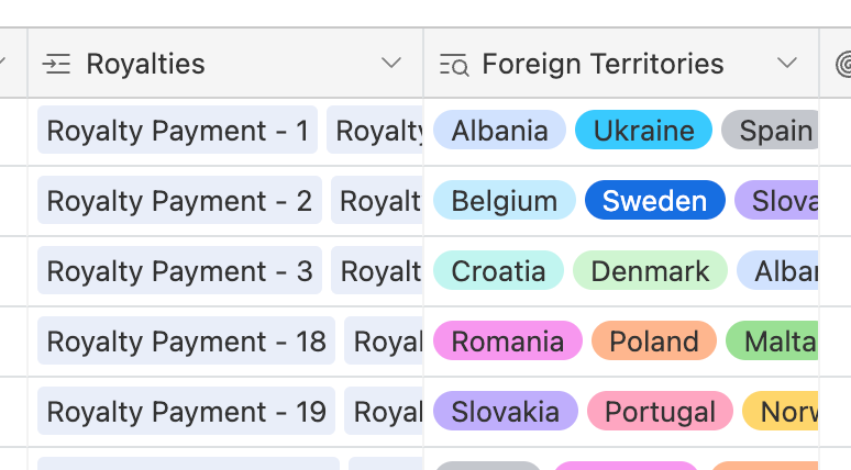

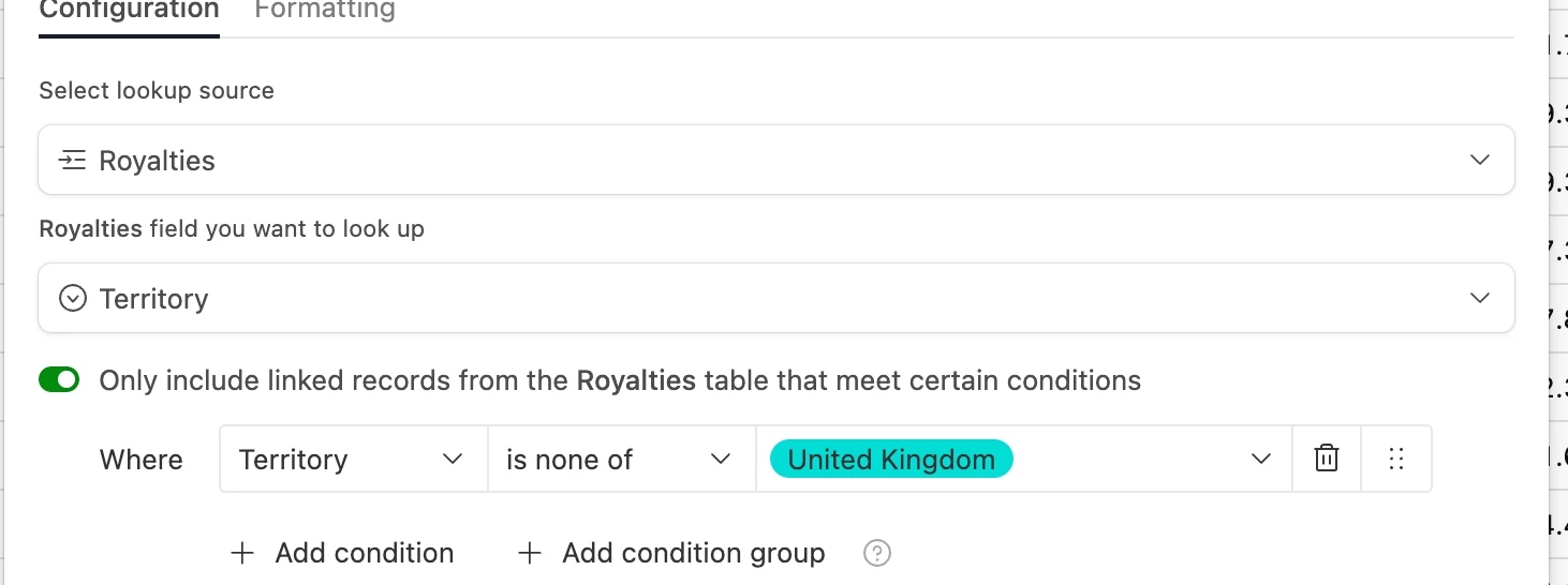

You could create a 2nd rollup field where the check the "only meets certain criteria" and set it to only be foreign transactions (to sum only foreign royalties).  You would then create a 3rd field that is a lookup that lists all the foreign territories from the royalties field where the "only meets certain criteria" is checked.
