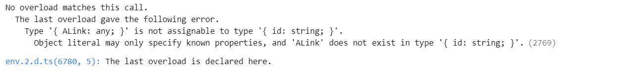

Thanks for this!  Unfortunately, this did not help for me...  For more clarity - I have these configured so that plain text input will kick off another automation to make these work.. essentially, what I really just need is to input the plan text values of StackerEmail & Alink.
for more context, I realized I can give more insight into the debugger:
FYI: I believe I found a solution.  essentially I abandoned using the alink field, and I abandoned the {[]} on the second part
"[For Stacker] A Email": StackerEmail,
 Thank you for the help!!
