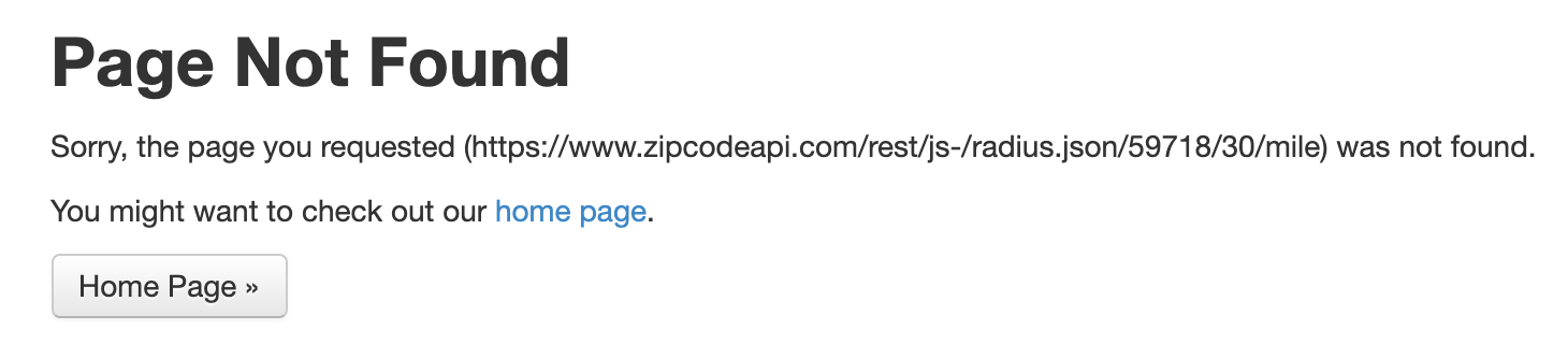

// @ts-nocheck
let response = await fetch(‘https://www.zipcodeapi.com/rest/js-APIKEY/radius.json/59718/30/mile’)
console.log(await radius.json());
I get:
### ERROR
ReferenceError: radius is not defined
at main on line 3
I did tried to add method, headers… all kind of thigs but with no luck. I know I’m doing it wrong.

Bill_French
It doesn’t matter how good your code is - if the endpoint doesn’t resolve, the API call will fail.
  • October 14, 2021
The api key is missing from your code :slightly_smiling_face:
It work when I use it as http get and not as JS code (from integromat and from adalo and from postman). But the zip code api company say it is possible. So I think its a problem with my code.
As I understand in Airtable this is the only way to do that?
Bill_French
I don’t have ANY code - you need to share your code if you want to get precise answers.
  • October 14, 2021
I just saw that the APIKEY reference in my code wasn’t show because it was in a
I change that.
But still it wont work without the key in the url.
There are demo option in the link I shared
  • October 14, 2021
the issue is you last line: console.log(await radius.json());
should be: console.log(await response.json());
  • October 14, 2021
Thank you, it is working now. I had one more problem that I needed to authorize airtableblocks.com also. not only airtable.com at the other side :slightly_smiling_face:
