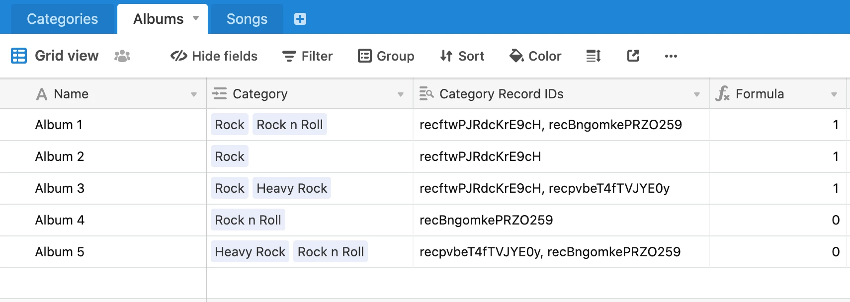

Hi @Dylan_Golow - yes, the names collision is going to cause problems, but you could use FIND() with with the record IDs. For example, with a table like this:
and a formula of:
FIND("recftwPJRdcKrE9cH", {Category Record IDs} & '')
you won’t get any identifier collision. (Note: you have to stringify the lookup of record IDs to get the formula to work). In an API request you’re going to end up with something like:
https://api.airtable.com/v0/YOUR_APP_ID/Albums?filterByFormula=FIND(%22[THE_CATEGORY_REC_ID_HERE]%22%2C+%7BCategory+Record+IDs%7D+%26+'')
But, at this point, as you are already in code, it might be easier to pull all records back and filter in the code (as you suggest above).
and a formula of:
