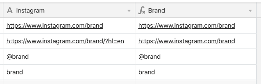

Your first attempt was pretty close, but I think what was hijacking the process was the order you chose for removing the pieces.
I started by first removing the most difficult part—everything from “/?” to the end—using this formula:
LEFT(
    Instagram, IF(
        FIND("/?", Instagram),
        FIND("/?", Instagram) - 1,
        LEN(Instagram)

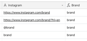

If those characters are found, the LEFT() function is fed their starting position minus 1; otherwise it’s fed the entire string length. That gets us this far:
Wrap that in a couple of SUBSTITUTE() functions to remove the other known items:
SUBSTITUTE(
    SUBSTITUTE(
        LEFT(
            Instagram, IF(
                LEN(Instagram)
        ), "https://www.instagram.com/", ""

Very nice. Formulas has never been my strong suit. Thanks for jumping in @Justin_Barrett.
