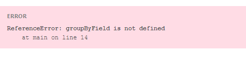

Hi!
I ran this but got the following error;
Any ideas?
Many thanks,
Ben
Hi!
Any ideas?
Many thanks,
Ben
In the script shared in your initial post, groupByField is an argument in the countByField function. However, in the altered version of the script that @Jono_Prest shared, that function doesn’t exist, so groupByField is never defined. Without that variable, you’ll need to replace groupByField with the literal name of the field.
